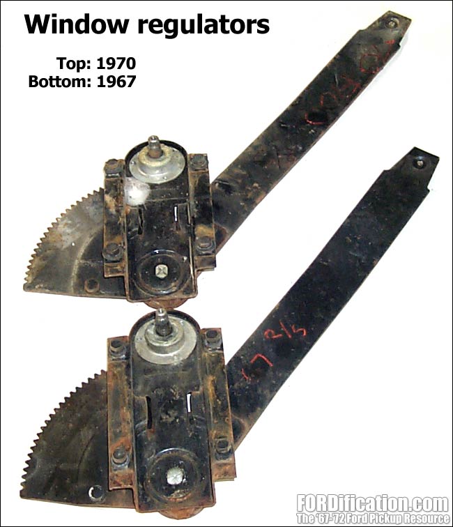

I don't know what they WOULDN'T work on the '68-'72 trucks, since the window regulator is the exact same part....no difference whatsoever. And the door release mechanism on the '68-'72 trucks is actually smaller than the '67 version, so I wouldn't think there'd be anything to get in the way....but maybe it does:

Keith, actually the '67 window reg. is a 1yr only unique part no. Also, note how the door release mechanism is lower on the 67-72s.

Comet: The window regulators are 100% identical between the '67 and the '68-'72 trucks. I set a '67 and a '70 piece side-by-side and looked them over VERY carefully, and see absolutely no differences between the two, even minor cosmetic differences. Here's a shot of the two (ignore the spider's nest in the '70 regulator...guess I COULD have wiped it down prior to taking the pic! ;) ):
The one thing I DID neglect to do was to make sure the regulator handles intechanged, but I believe they do.

Keith, if you look in the catalogs like DC they all list a different part no. for '67 only. If they were identical, they would have the same p/n. There must be something different. In addition, when I was looking in junk yards for a reg. for my '71, I firts bought a '67 and it did not fit. I do not recall what was wrong exactly, but I thought it had to do with the mounting locations. Not really sure though.

In looking at the two a little closer, does the crank shaft look shorter on the '70?

I will definitely check that out within the next few days and report back. That would be good info to know.
