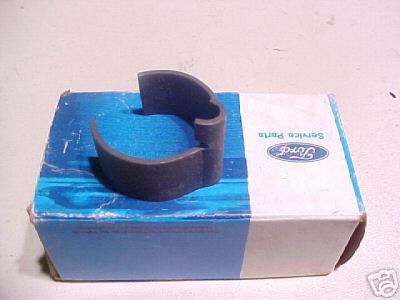

This is what the factory piece looks like.
It snaps onto the bottom of the steering wheel hub. Sorry for the bad pic, it's the only one I had:

Crap, dont have it. I am going to try to get it from the source I bought the column from. If that dont work, I guess its junkyard time.
Thanks for the help and pics!

Well, relief, I managed to get a friend to pick up the part from the junkyard today. Its gonna be fun trying to fit it on the grant hub, this thing has some amazing tension in it.
