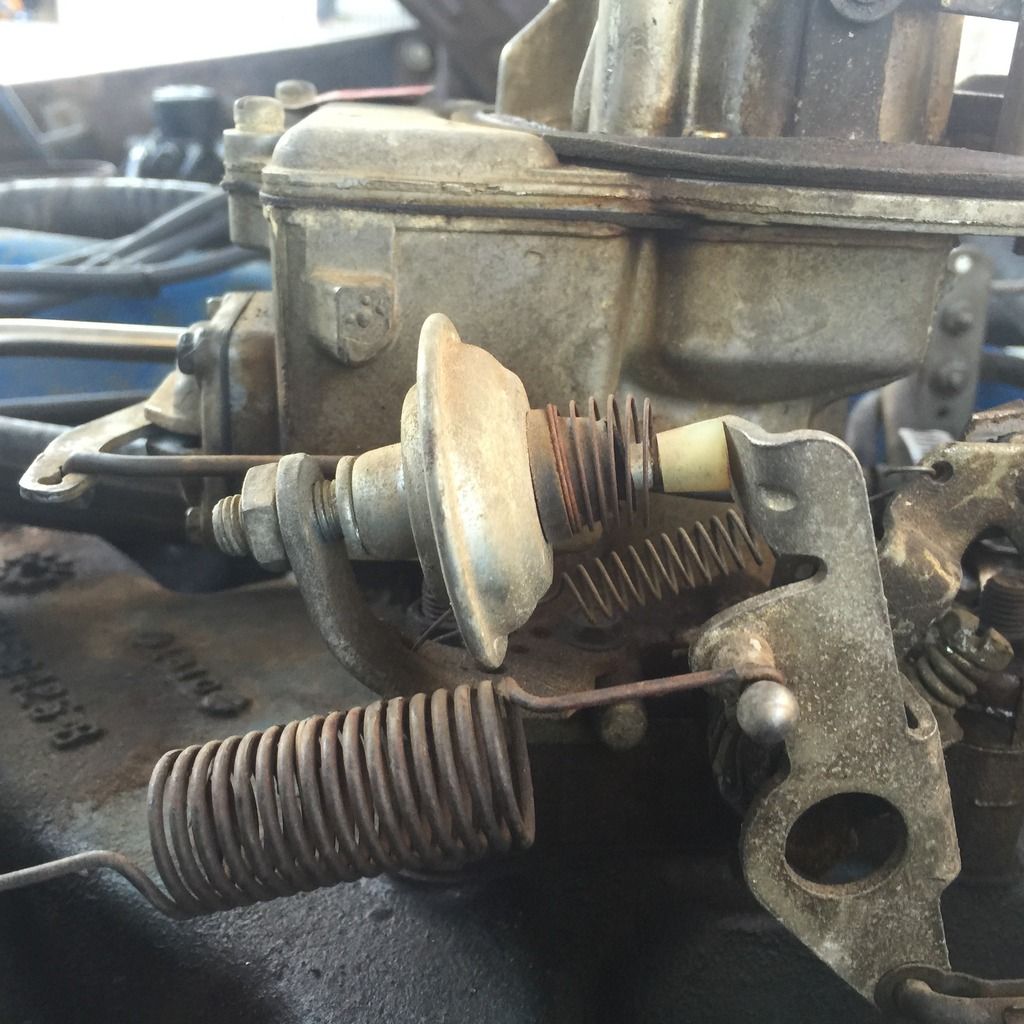

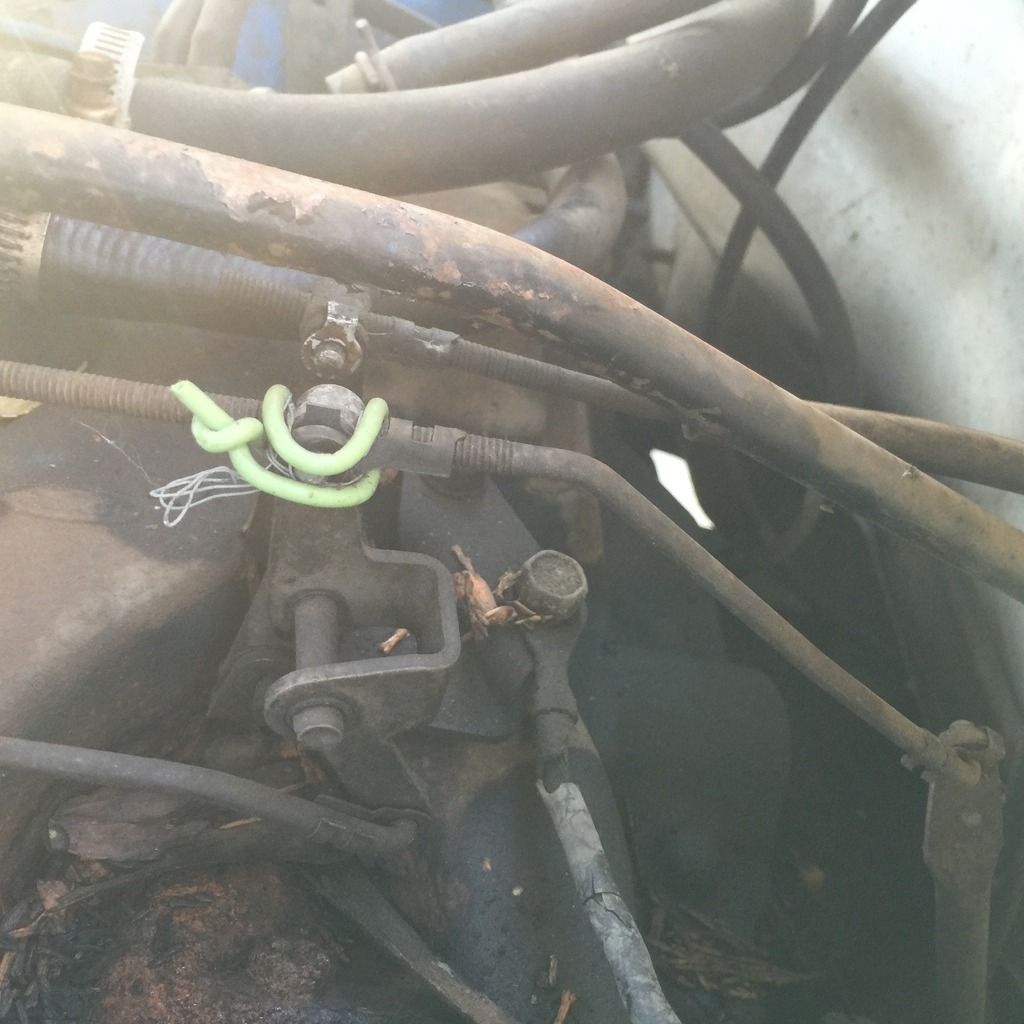

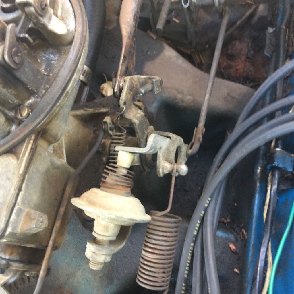

Installing my stock manifold and carburetor on my 71 F250 360 2 barrel automatic. Can anyone provide a picture of the linkage configuration showing both arms and the bellcrank

These are not great, but I had them in my photo file. I can snap some more when it cools off as it is hot as Hades here. Oh, BTW, ignore the PO's attempt at using wire to double/triple secure the linkages over the top of the factory ones. He had a lot of those little quirks around the truck.
Let me know what else you want pics of. Mine is a bone stock truck with low miles and has (mostly) unmolested parts intact.
