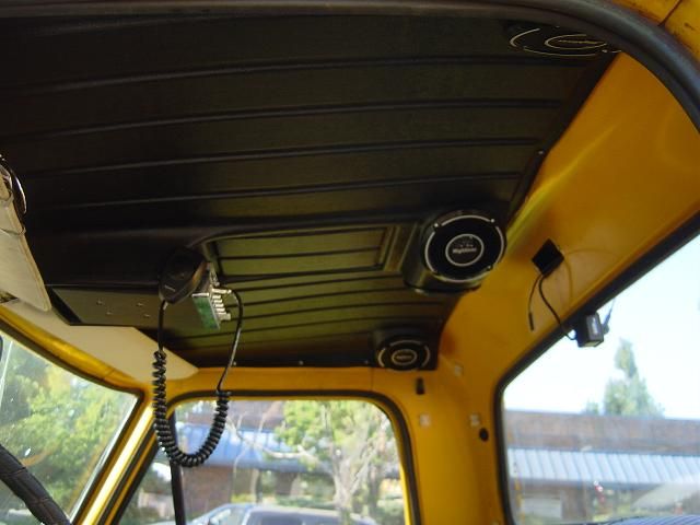

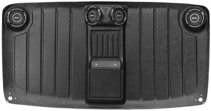

Forgive the Hijacking but Craigerf100, Could the space where your CB radio is, could it be used as a storage space instead of a radio?

The pics above are not my truck but yes when I get mine I plan to turn it into storage like in this pic.
