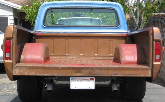

I'd also like to chime in as I was going to post a very similar thread topic. I'm building more of a street truck, (CV front and axle flip rear). I'm wondering what backspacing will i need for a rim?
I first read somewhere to run a 5.5 backspacing, but now this guy says to only run a 4.75 BS, anything else will not fit the tire. Anyone have experience in trying to run a MT street radial.
I'd like to run a 295/65/15, or even a 275/60/15. Keeping a tall tire and having lots of sidewall is key for this set up. (I believe...)

Mine : )

325/50-15 with massaged tubs. 15X10 Wheel Vintiques with 5" backspacing. If you keep the tire under 300mm wide, no tub mod is necessary for clearance.
