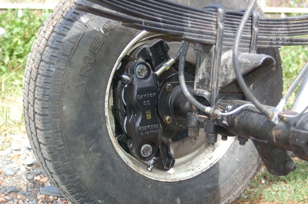

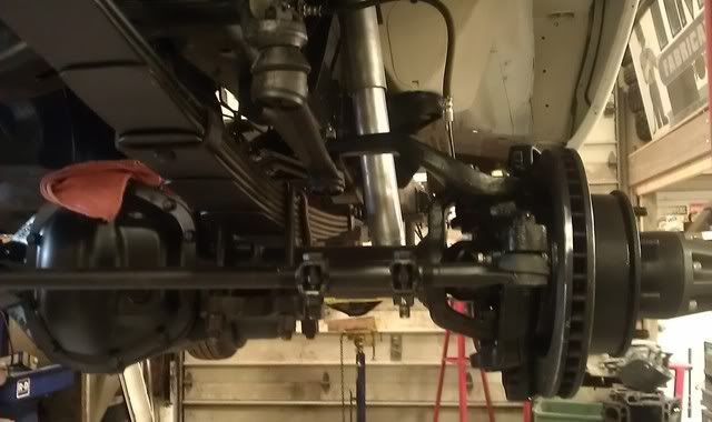

Re: 1972 8 lug dana 44 drum to disk conversion
On my 72, I switched my front Dana 44 to a 1977 Dana 44 with factory disc brakes, I researched for month's on how to convert the 72 axle to disc brakes but it was not worth all the work to convert it, so I just found a 1977 axle and had it rebuilt.
I also switched my rear Dana 60 to disc brakes, It made it the smoothest, quickest stopping old truck in town, and YES it was worth doing it. I added a few pictures of front and rear axle for you to see the results.
And to answer your question before you ask, there are no parking brakes on the rear disc, I added in the rear brake system a Park-Loc Hydraulic Brake that releases when you press on the brake pedal.
More info on the Park-Loc http://www.speedwaymotors.com/Park-Lok- ... ,1970.html
I don't use it unless I have to park on a hill or somewhere unsafe.
More info on Rear Disc Conversion. http://www.ncspecialties.com/autobody/r ... /index.htm
