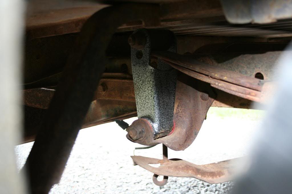

TD, not saying your advice isn't spot on just wanted to question the spring hanger flip, is welding required or can grade 8 fasteners suffice?

Banjo wrote:TD, not saying your advice isn't spot on just wanted to question the spring hanger flip, is welding required or can grade 8 fasteners suffice?
Banjo,
grade 8 will do fine, thats what i used on mine and no probs at all!
you will use two of the existing stock wholes and have to drill two of your own.
i also removed a little material off the bottom edge of the hanger which when flipped will
be the top and clearance is tight against the bed floor so its a good idea to make a little
more room so's not to have any vibration rattling issues. :thup: :thup:

Before
After
Between the blue tape lines is the amount of drop just invertting hangers
Tony B.Image
