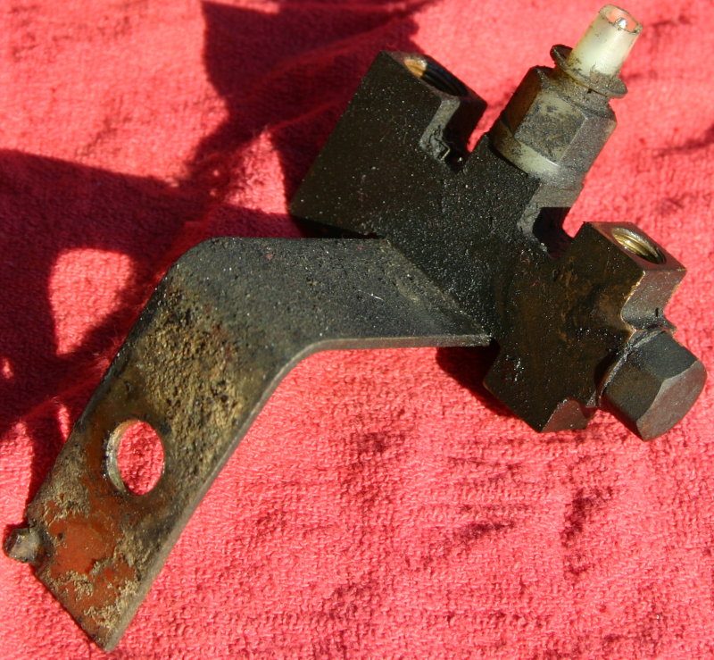

Here's the disc brake proportioning valve out of my truck:
Does anybody know of a vendor for this valve?
Thanks!
-Robroy

I think it was LMC that has has them for stock(drum/drum), front disc/rear drum, and for 4 wheel disc.
Also check NPD..

It really isn't a proportioning valve, just a distribution block with a shuttle valve for the warning light.
Unless it is stripped of something there isn't much that can go wrong with it.

That's not a disc brake proportioning valve....that's a drum-brake distribution block.

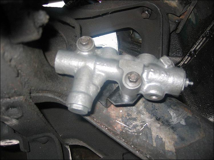

The disc brake prop valves pictured above are the '73 thru early-'77 style that get mounted on top of the steering box. The late-'77 thru '79 prop valves get mounted to the backside of the front crossmember. Here's a picture of that style taken by one of our members who was mounting it to his bumpside:

Robert, thanks for the clarification! I had this all wrong. And since there were no symptoms of bad behavior that I can remember, I'll just clean it up and re-install it.
Keith, thanks for the illustrations! I understand what's going on now. And please freely use all photos I post links to here; I'm happy about any contribution I can make to this great site!

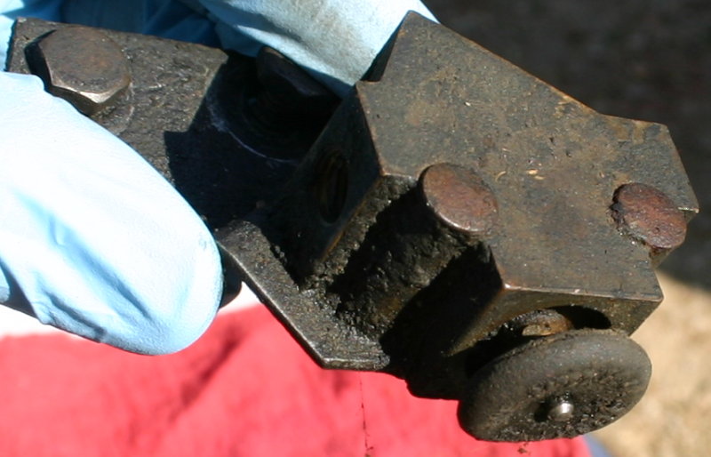

Here's the high resolution version of the same photo if you're interested in it. Some patience will be required as it loads from my slow web server:
http://www.robroygregg.com/Number50/IMG_5822.JPG
