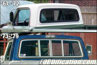

The rear windows on bumpsides are specific to 67-72 or do they interchange with 73-79 ?

If I remember correctly the Front ones will interchange but the rear windows do not. They are a little taller and come to a point on the bottom corners.

:yt: They're not even close. In fact, the '73 dealer brochure specifically mentions the "...39% larger rear window".

Side note the 73-79 rear windows interchange with the 92-95ish bodystyle fords.

73-91 interchange on the dent side rear glass. i looked it up in a mitchell manual

im pretty sure it said to 91. i didnt question it but the book at the library is not a new book either i foget whhich year it was published. i will have to check on when it was published to be for sure.

just to report in on the source i used to determine the rear glas interchange for the dent sides. the book i got the info from was a 1988 edition book. i relooked it up and it said the glass was for 73-79 only the 80 and up trucks used a different number for the glass interchange. but i know i read someplace that it was up to 91 for the interchange but maybe that source was wrong i dont know.

The rear glass is the same from 73-96.I have a dent rear window in my 96. :)
