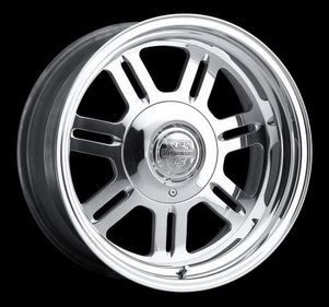

Hello guys, looking to get new rims and tires, im new to the F100 world so im not 100% what works. My question is if this size tire will fit my 71? Also if it did, would it look right. I have 275/60/15 on it now.
These are the rims im wanting 18X8 fronts and 18x9.5 backs
http://www.centerlinewheels.com/wheels_ ... &sw_id=436
And tires are 255/55/18
http://www.discounttire.com/dtcs/findTi ... H2&rf=true
Please offer any opinions or expert advice :thup:

Thanks guys :thup: Looks like im going with 17's 8 in the front & 9.5 in the back. Im going with 255/50/17 F and 275/50/17 B. Now I need to figure out what offset backsapce I need :?

customcrewcab wrote:ok whats the backspacing? i didn't see it. i am guess you want them to sit inside the wheelwell?
Well since they are going to be custom made, they can be made from..
Rears 17 x 9.5 4.0" to 7.0" BS & Fronts 17 x 8 3.5" to 5.5" BS
I would like the wheels to sit under the wheel wells.
Ok, please tell me how I should order these wheels (offset, backsapace etc..) How would you order them? I need help with this, I need to make sure they will work on the truck.
Thank you very much for your help :thup:

for that size rim and tire anything over 3.5 bs may give you problems. i was running 17x8's with 4" bs (275/60-r17) and although they seemed not to rub the inner fender in the rear, after removing them i found they were rubbing. i don't know if it was from turning or what, but they had been rubbing.

4" b/s should be just right as long as you have the stock width rear end....
