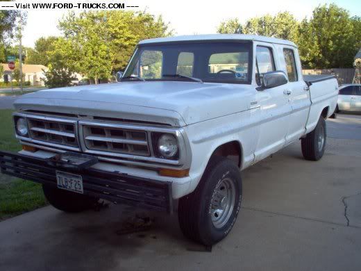

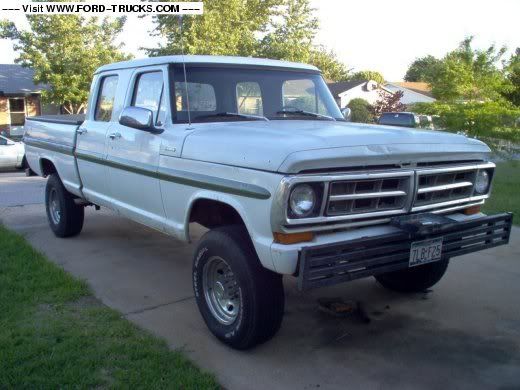

Seeing as those losers won't let Y'all see it, I'll just tell ya what it said...
For sale 71 F-250. I-beam flip. Needs front end adjustments. 4 wheel disc. A/C was working, not sure now. 390 rebuilt approx. 3500 miles since install. T-18. New rims and tires from Discount tire

ima71 trucks are older
Posts: 142
Joined: Tue Jul 10, 2007 10:39 pm
Location: Washington (the dry part of the state)
Post by ima71 trucks are older »
you know its bad when you can eyeball the camber problem caused by fliping them.
