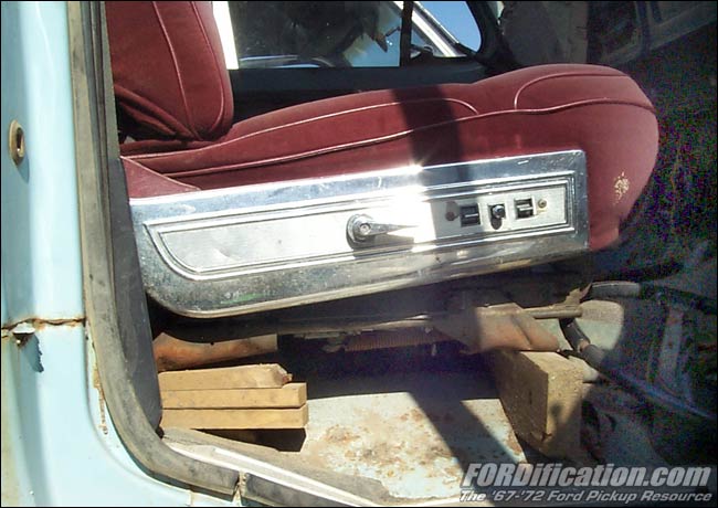

You're going to be pretty much on your own regarding fitting a pair of buckets...each one's going to be mounted slightly different, and will require custom-made brackets. It's not hard, just takes a little ingenuity.
Just don't do what this guy did. I found this in a U-Pull-It:
Redneck ingenuity at it's worst?

How'd ya get a pic of my truckFORDification wrote:You're going to be pretty much on your own regarding fitting a pair of buckets...each one's going to be mounted slightly different, and will require custom-made brackets. It's not hard, just takes a little ingenuity.
Just don't do what this guy did. I found this in a U-Pull-It:![]()

That looks like my old 73 only my seats where blue.oldbiker wrote:How'd ya get a pic of my truckFORDification wrote:You're going to be pretty much on your own regarding fitting a pair of buckets...each one's going to be mounted slightly different, and will require custom-made brackets. It's not hard, just takes a little ingenuity.
Redneck ingenuity at it's worst?![]()
J/K
Not bad only it moved your head 5" closer to the Roof, so you realy knew when you hit a bump (in the road, not a truck)
