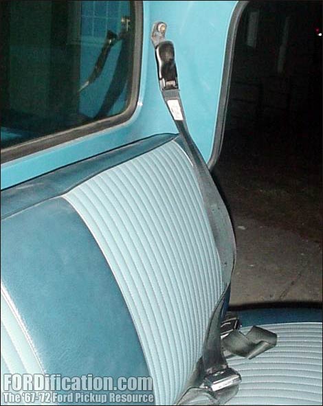

No, it would take a considerable amount of work to make them fit. They don't just bolt onto the outside of the cab wall...they're sunk in.foghorn wrote:Keith correct me if im wrong but wouldnt a set from a 73-79 just be a direct bolt in?
Foggy![]()
Just for the visual, here's a picture of a factory setup from a '72:
...and here's a shot of how the '73-'79 trucks shoulder belts are mounted. You can see how they're sunk into the pillar:
