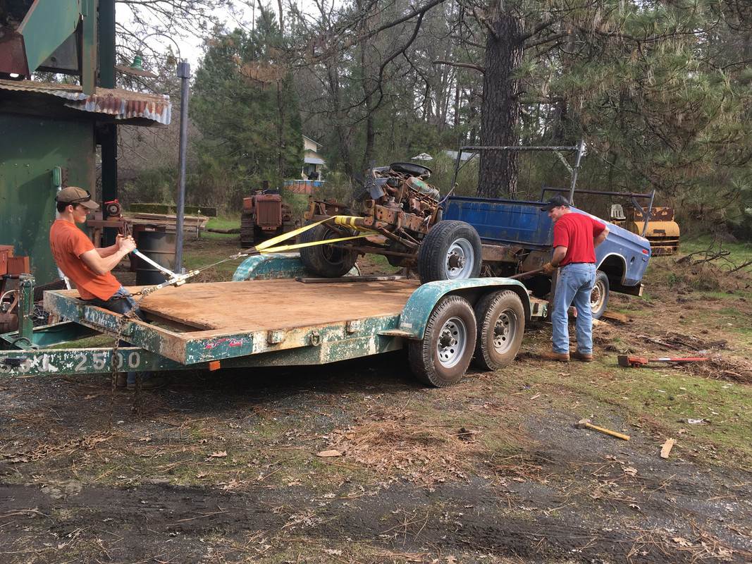

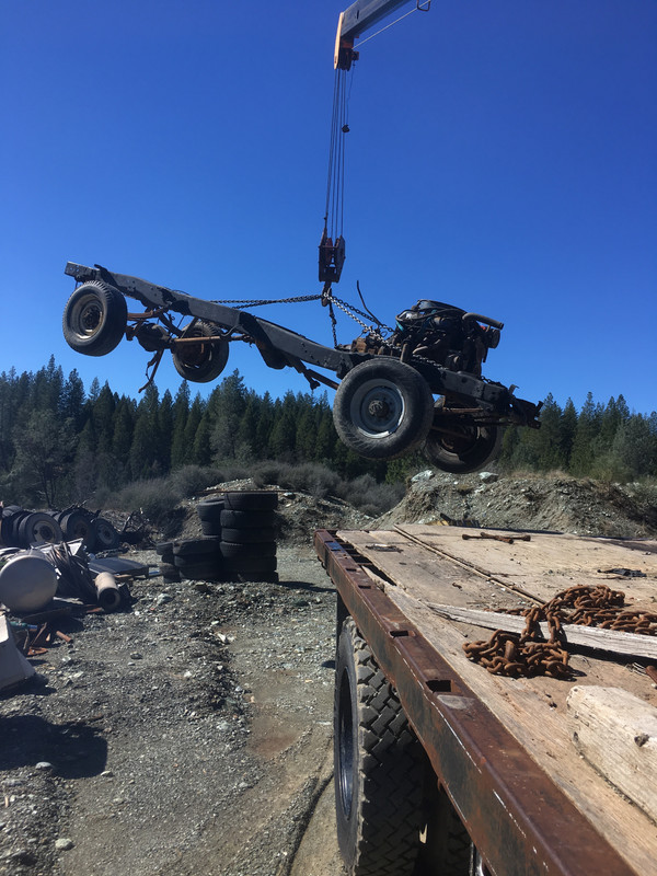

Having (literally) dealt with about 10-12 vehicle extractions, I can recommend several methods. The first is the "Hammer-Down" method, involving a 4x4 and lead feet. That has worked on several trucks and cars I've been involved with moving, just make sure you have a clear path. The second is the "Hub Beater" technique, involving a sledge and pounding on the victim's hubs. It is occasionally used before the previous method. The final one is a truck, a trailer, some bars, and a come-along (hand winch) or a bumper winch. Use the hub beater to loosen up the brakes (50-50 chance), and then haul it onto the trailer. A method I won't recommend is a crane. It works, but I don't think you have access to one nearby. All of these were extracted, in part, by moi. All the above methods were used successfully. Photos 1 and 3 were "Hammer-Down"s, 2 is the "Come-along" and 4 is the "Wheee" method.
