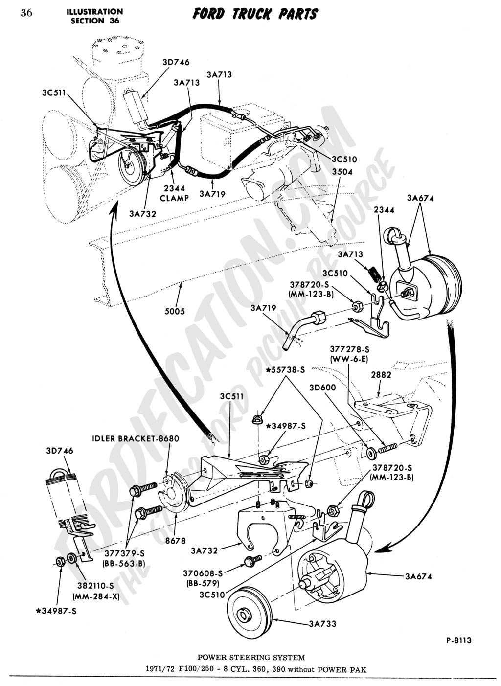

Thar spacer is the same thickness as the A/C compressor bracket, which on A/C equipped trucks went on in place of the spacer.
The bracket is part 2882 in this diagram:
http://www.fordification.com/tech/image ... tegral.jpg
The thickness there is .365", or just a whisker shy of 3/8". You could probably stack some washers there to get the thickness.

Great then I'm good to go with the one I used. Thanksflyboy2610 wrote:Thar spacer is the same thickness as the A/C compressor bracket, which on A/C equipped trucks went on in place of the spacer.
