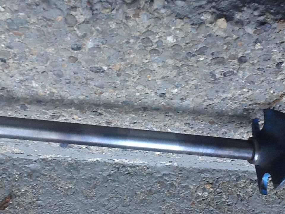

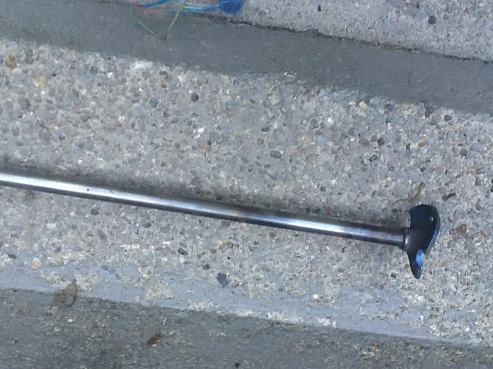

This is what it looks like now. I'm sure you all know what a bad one looks like...
I'm so bad at taking before and after pics. I just charge into stuff to get it done....

- Posts: 1177
- Joined: Fri Jun 03, 2011 11:01 pm
- Location: Burney Ca.
Re: Steering shaft repair
Good job man! Keep it alive
