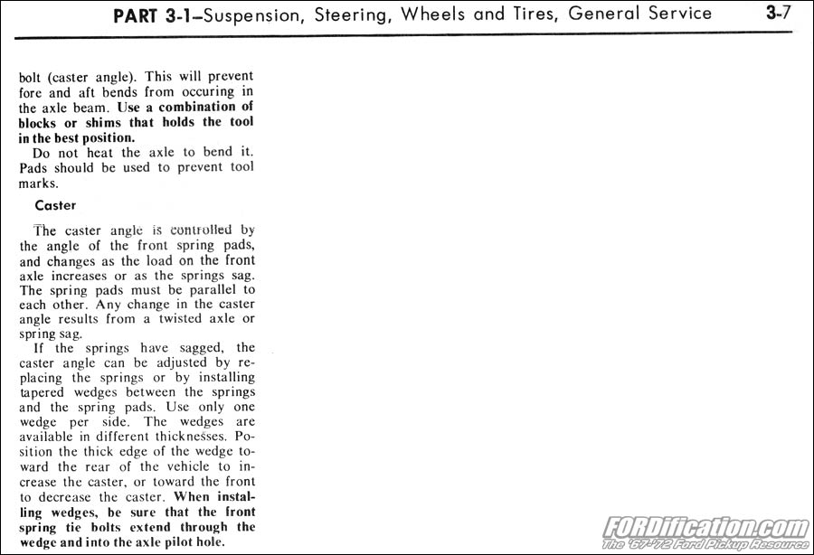

I am referring to the article in the Tech section of this website on alignment. There is info copied from a 1967 service manual regarding the I Beam suspension. The first part talks about cold bending for Camber and Caster but the last page (section 3-7) talks about Caster again and the front spring pads & using wedges:
http://www.fordification.com/tech/image ... ding03.jpg
Couple of years ago I took my truck to a specialty place that did cold bending and they set the Camber and Caster. But I do not think they twisted axle enough to increase the Caster enough. Thinking of putting in new front springs and if a wedge could be put in at the same time for more Caster than I would like to try it. Article seems like they are talking about front coil springs

That's speaking about leaf spring wedges.

Re: Tapered Wedges
You guys must be right and they are referring to front leaf springs from 4wd or HD trucks... They sure had me fooled since all the pictures show front coils
