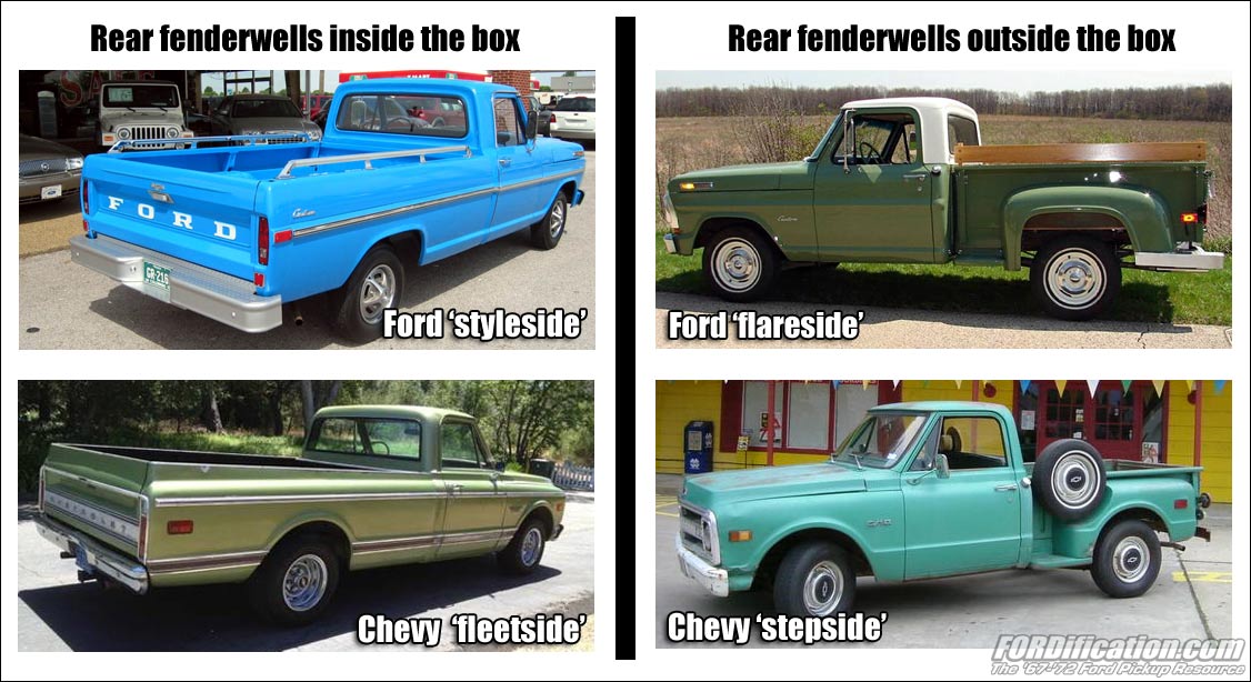

Welcome to the Ford truck world. Just to get you up to speed, the term 'stepside' is a registered trademark of Ch*vy and doesn't apply to Fords. They have stepsides and fleetsides, we have flaresides and stylesides.
