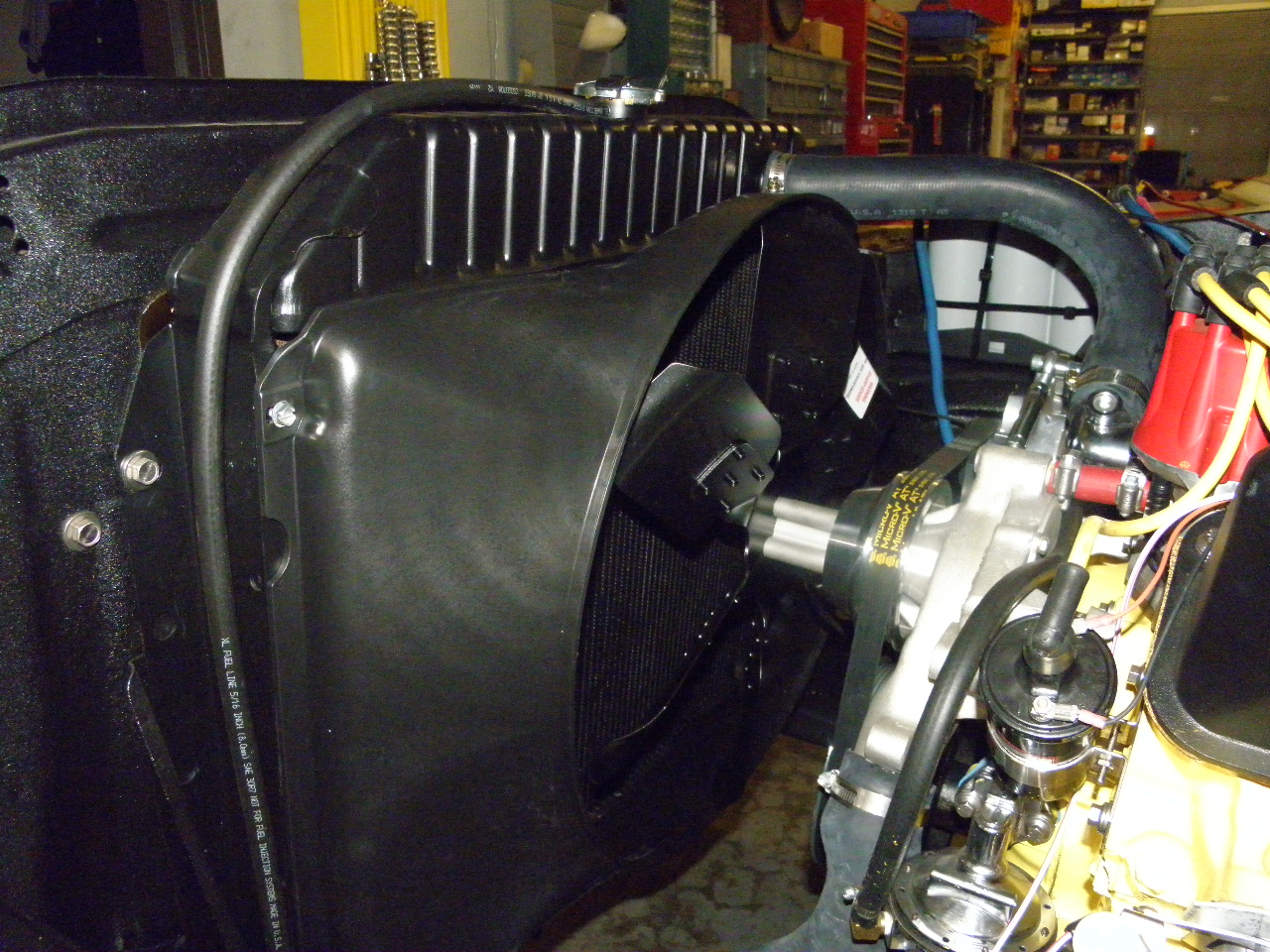

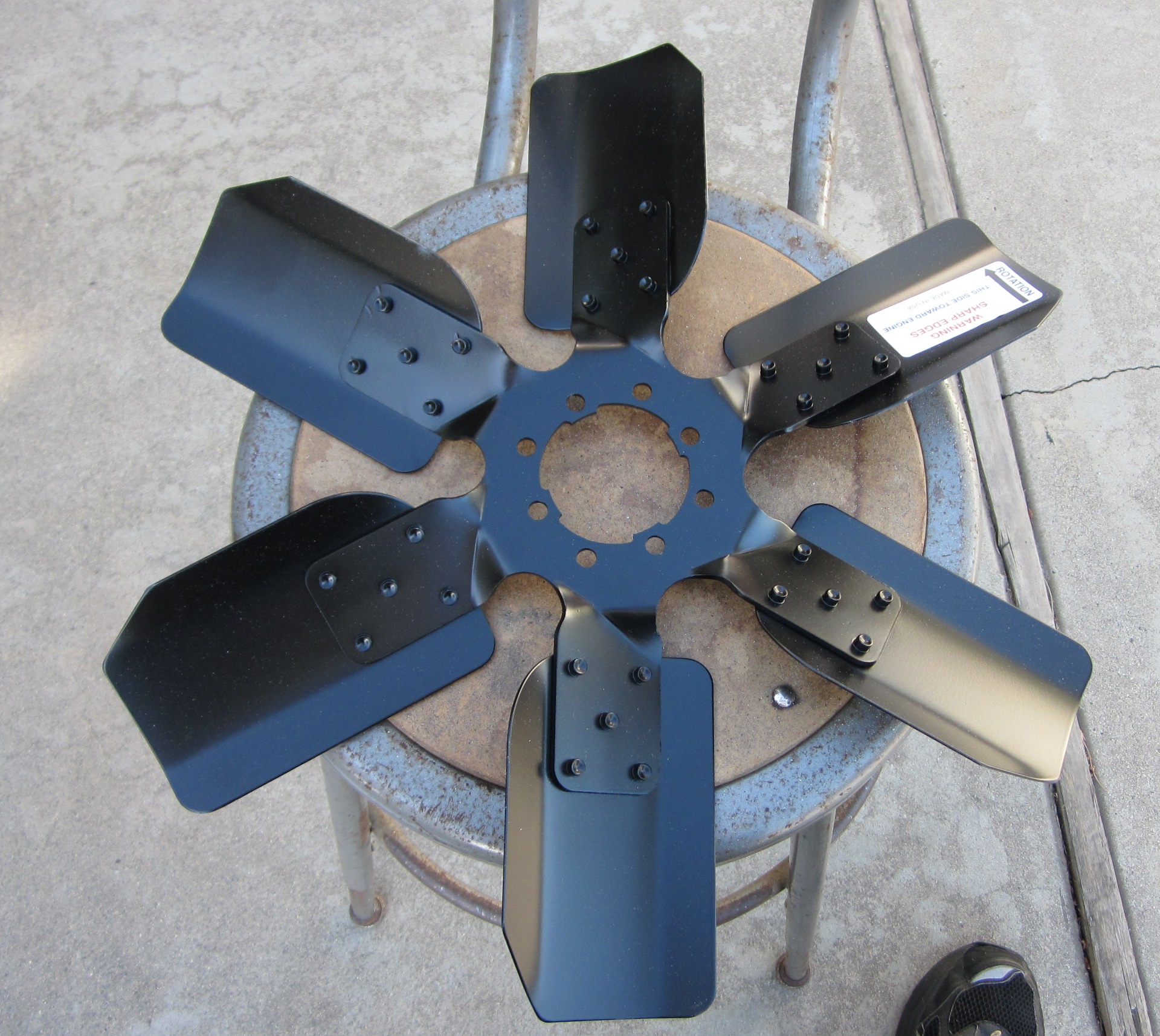

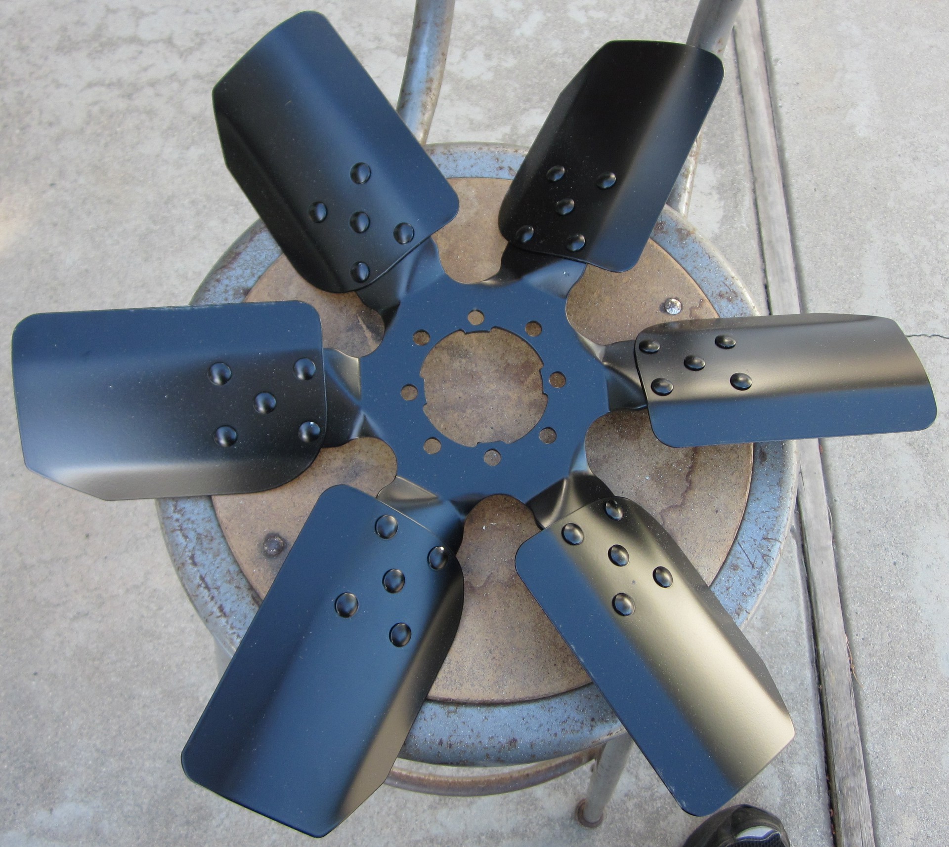

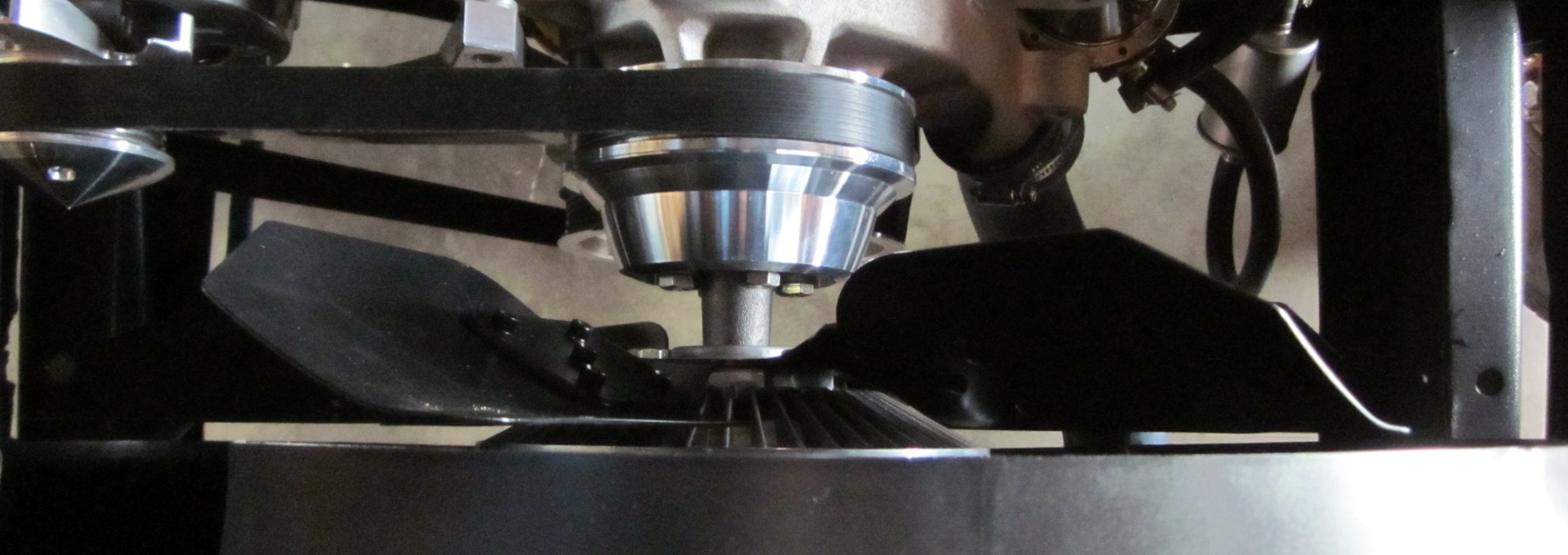

Does anybody know the specifications of the fan that my truck came with? What was its diameter?
As some of you know, #50's a 1972 F250 FE+T18 bare-bones model.
Here's a photo that shows the factory-style fan shroud I'm using (it's a reproduction from LMC): 2011Feb24_FESpecialties_C.JPG
I think this shroud's a super common type found on FE Bumpsides.
My reason for asking is this: the Derale P/N 17319 19" fan I'm using now is very loud (probably the noisiest thing on the whole truck), and I'm planning a thermostatic clutch fan setup to help reduce the noise. But the Derale fan I have now comes really close to the edges of the shroud--I had to clearance it slightly in one spot, in fact. So I'm hoping that this shroud's really meant to accept an 18" fan instead.
Thanks very much!

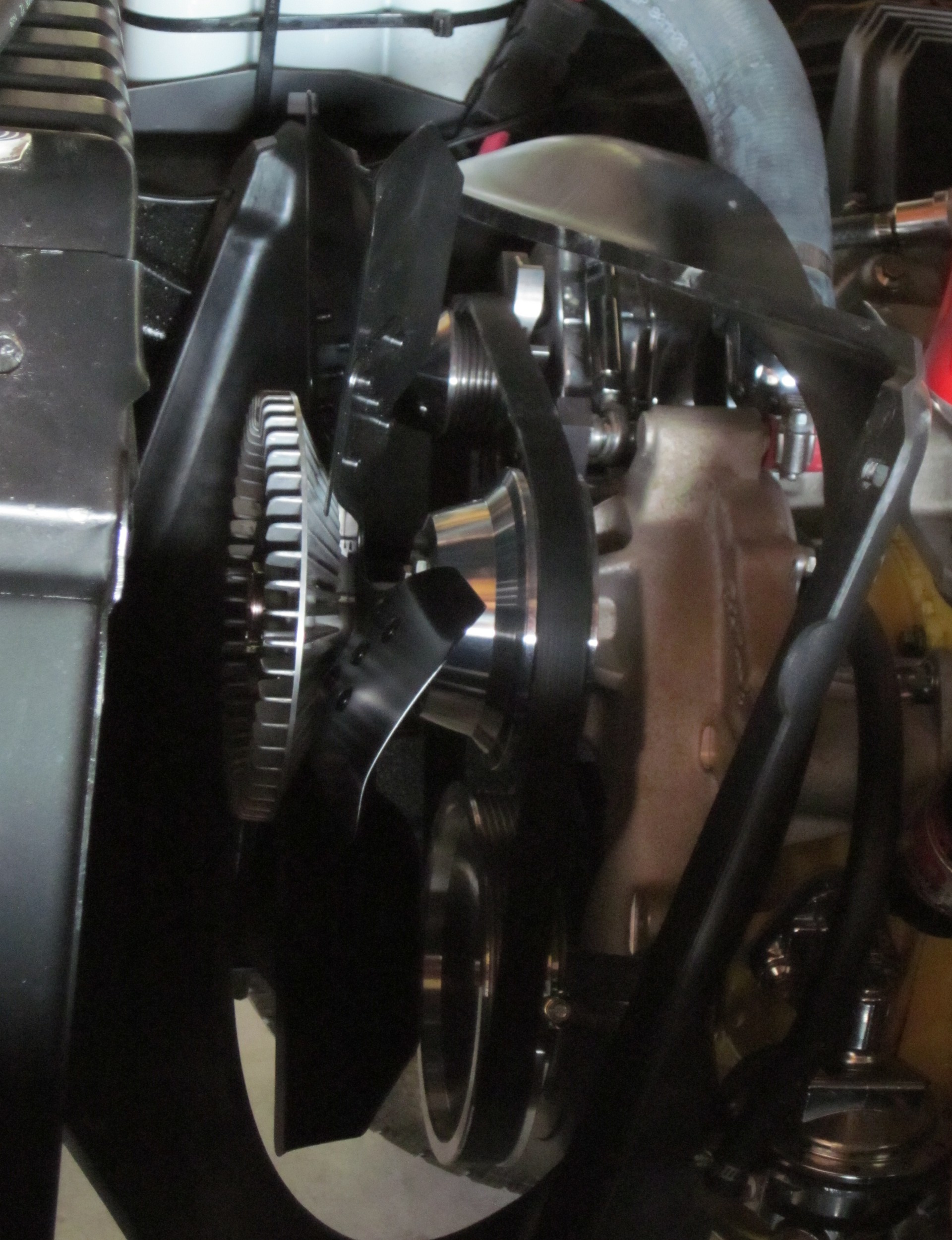

Good afternoon Larry and Fordman, thanks for your superb replies!
In fact, that's how I discovered my clearance problem with the 19" fan! The first time I gave it a little gas I heard a weird "crack" sound, and I found a chip taken out of the inside diameter of the shroud hole when I got home. I was actually pretty lucky that the fan didn't just eat the shroud alive!
Might anybody else have a stock FE fan diameter measurement? Larry's 18" figure is excellent, yet naturally, I always like to hear the same number from multiple folks before breaking out the credit card.

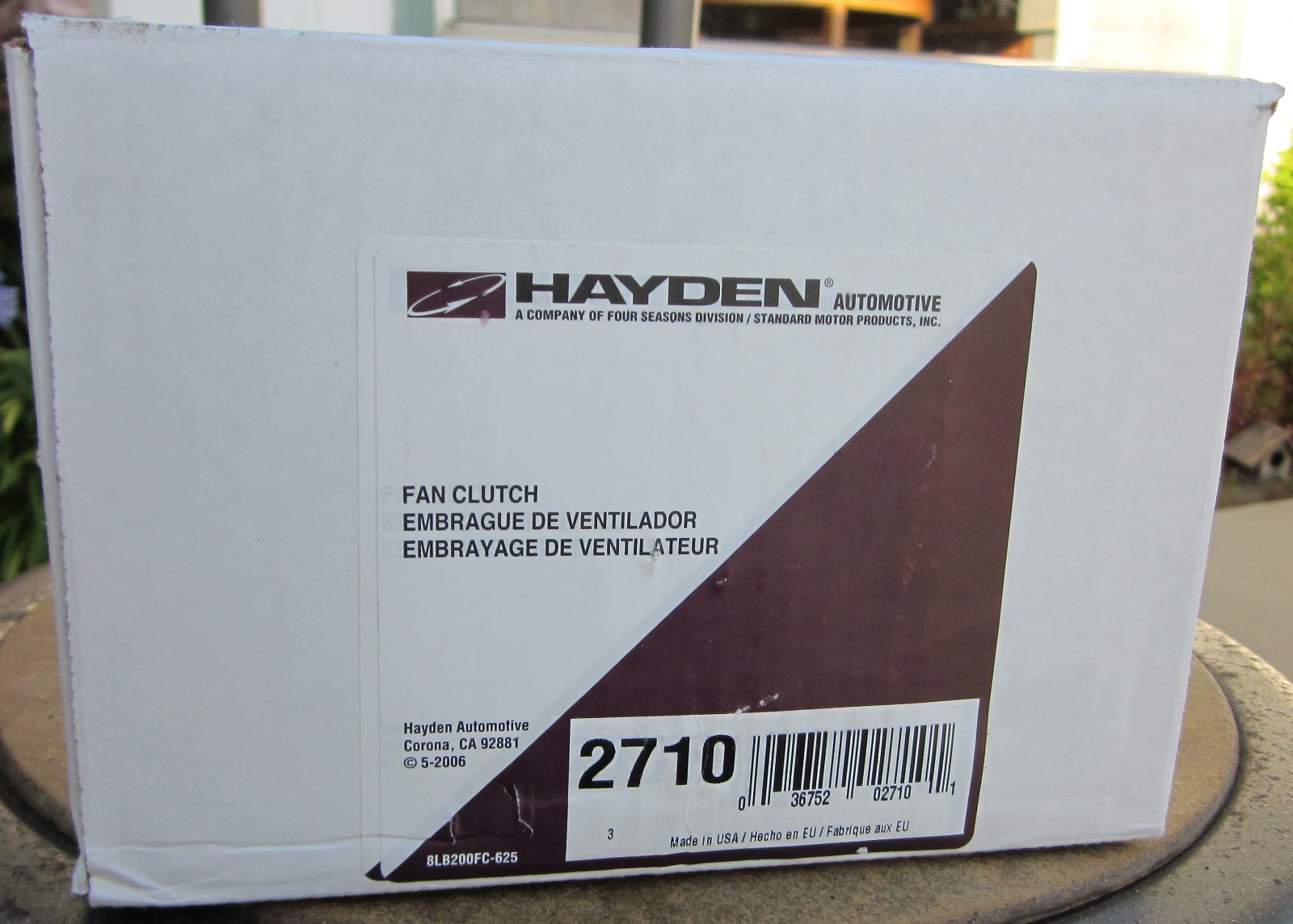

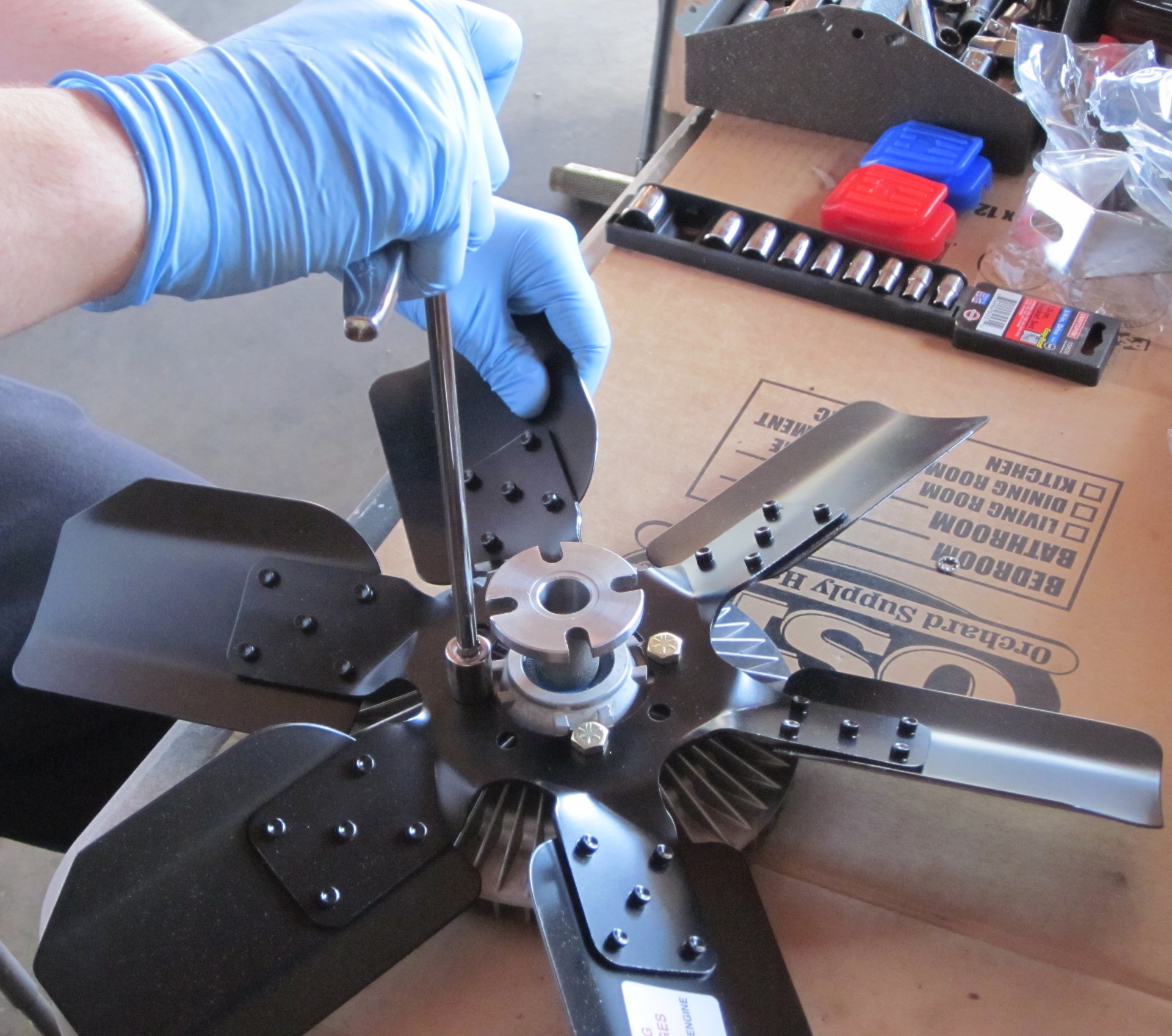

Today's Updates:

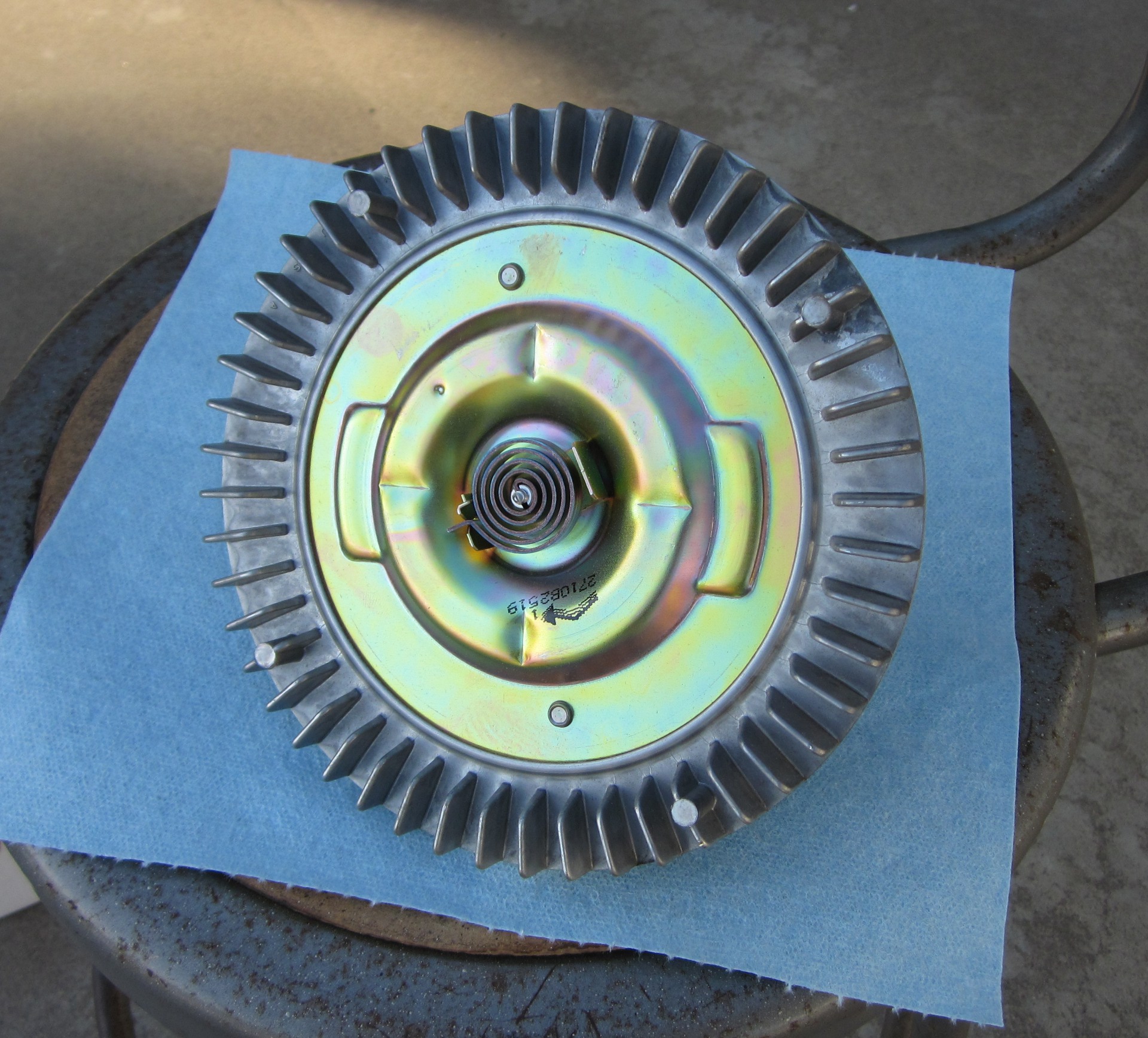

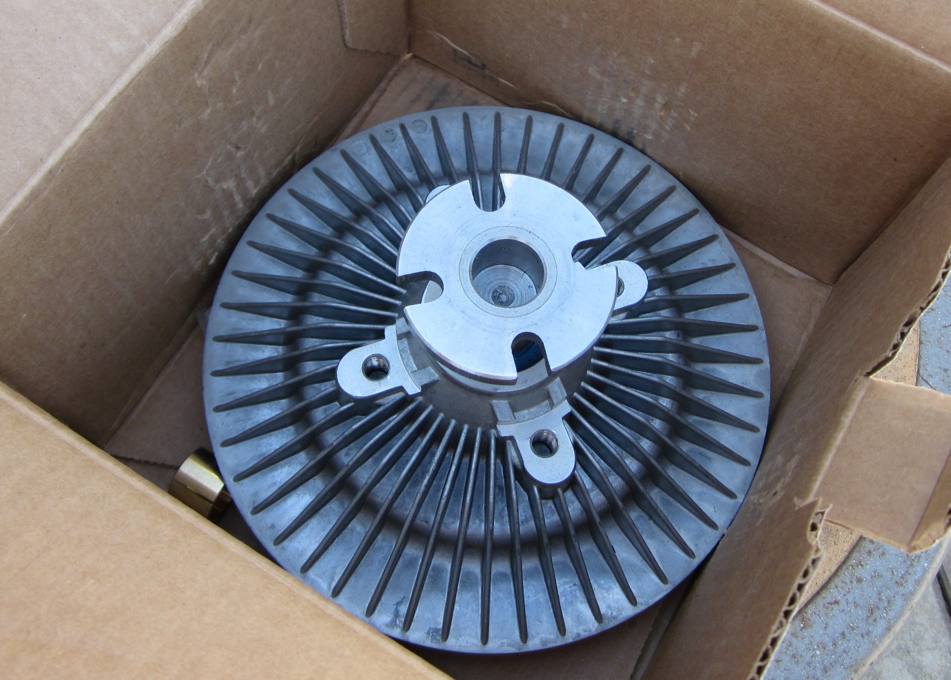

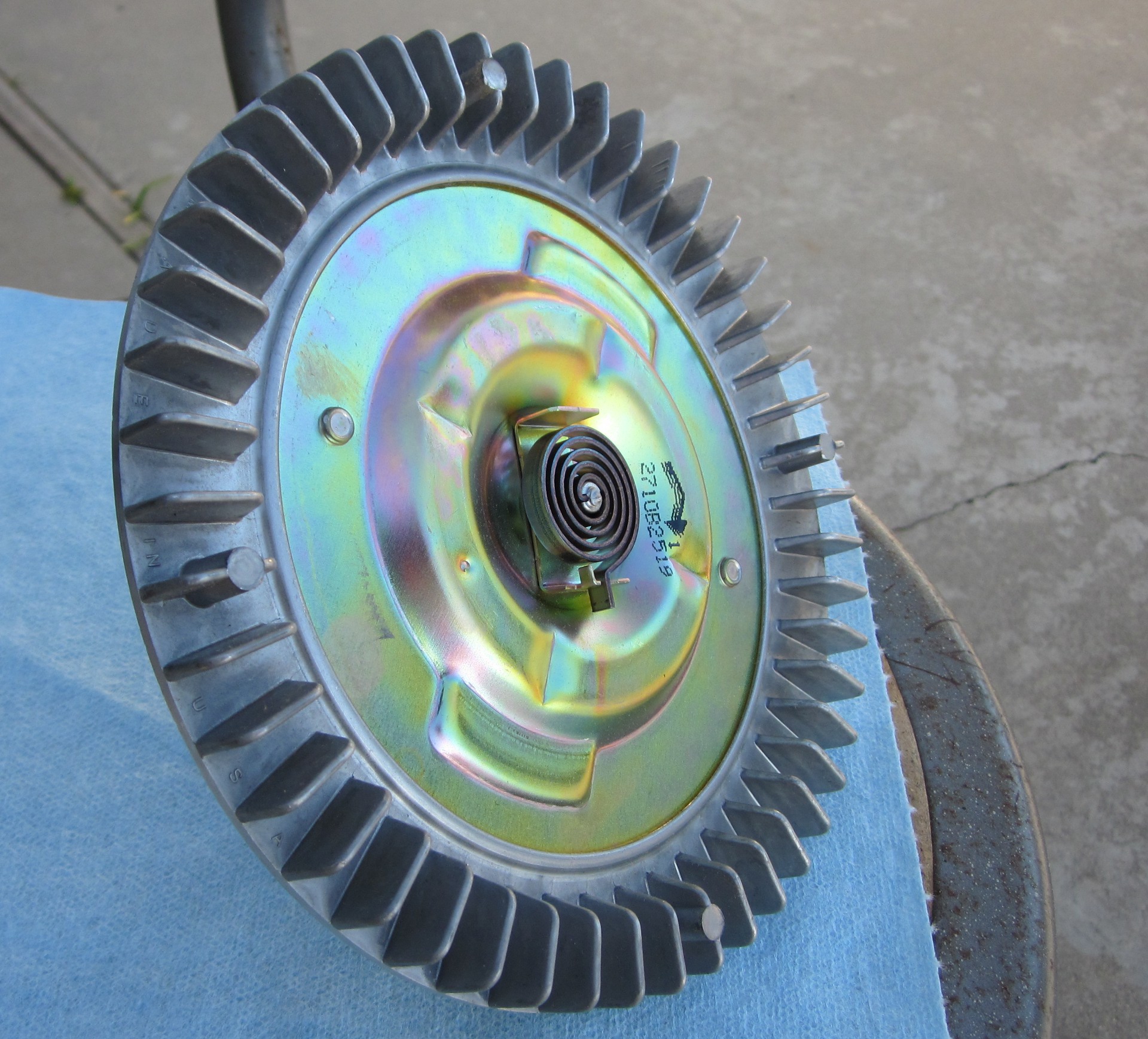

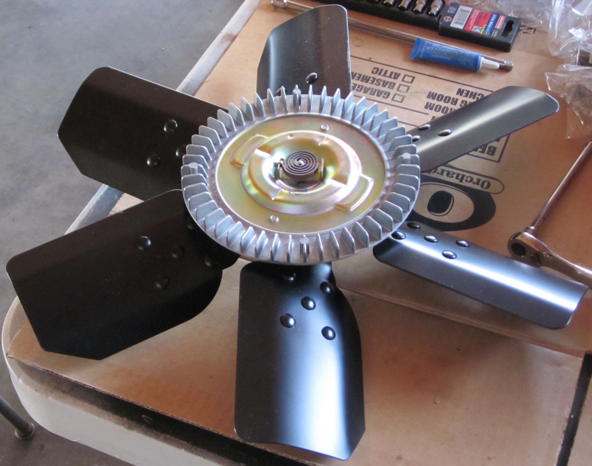

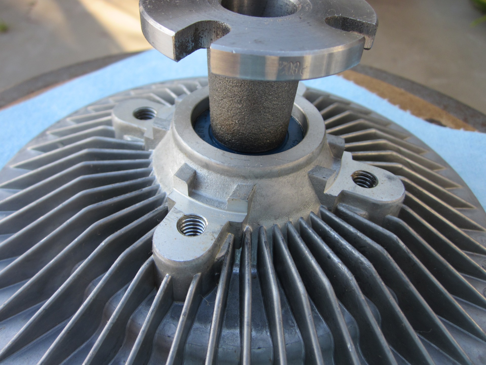

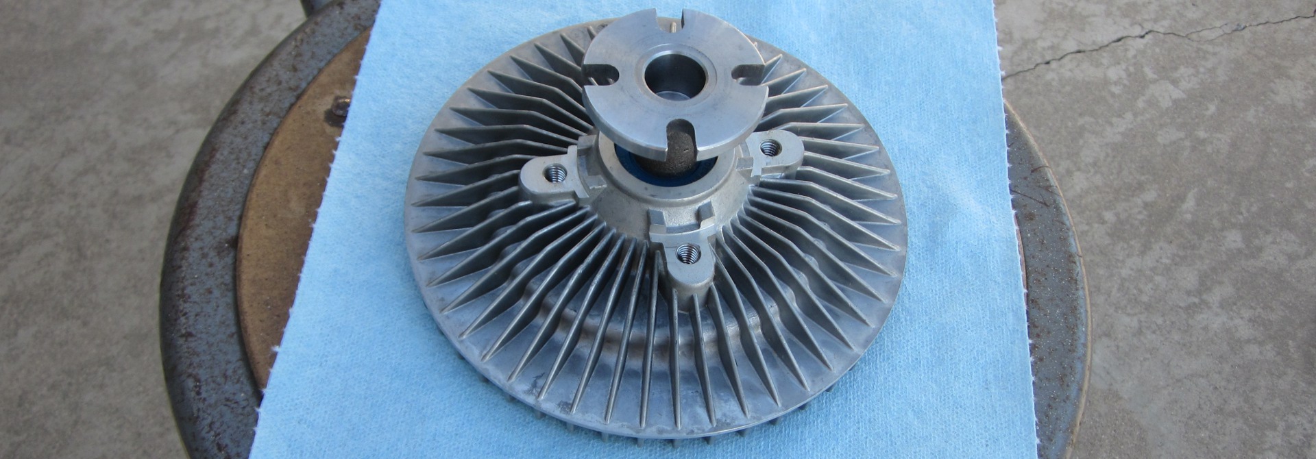

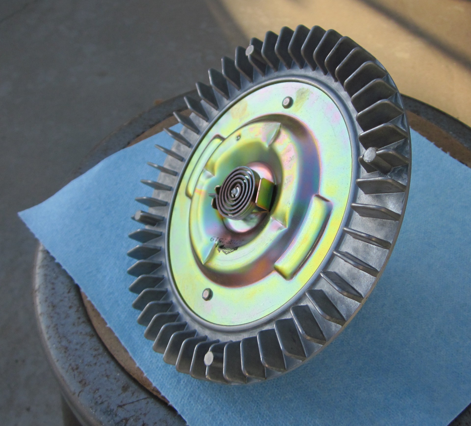

Based on advice from Dustin (AverageF250) in another thread, I ordered a Hayden 2710 fan clutch. It was only $32 from Summit and is USA made. I also ordered a Derale 17118 18" fan to get with it ($41 and also USA made). Thanks so much to everybody who spoke up here with their stock fan diameter!
It's also finally Spring time around here, which sure makes it more fun to work on #50. As you guys know, all of these photos can be clicked on to see much larger editions.

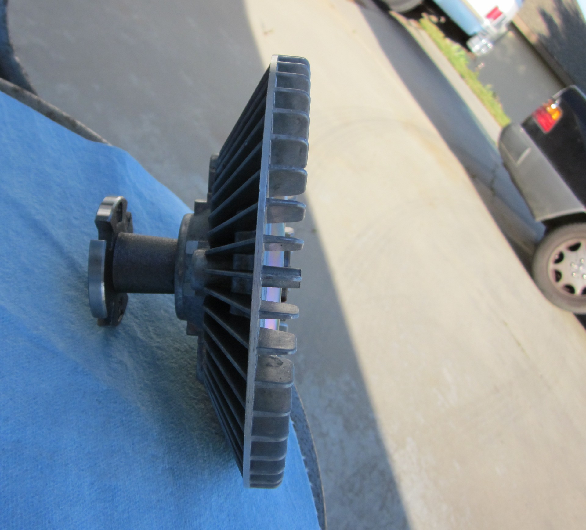

Here's the Hayden 2710 clutch. I was impressed to see that it was USA made after paying only $32 for it. Thanks very much to Dustin (AverageF250) for posting about this clutch.
The seal on the back appeared to be ever so slightly oily, but it didn't seem like it was leaking. Hopefully it will be OK!

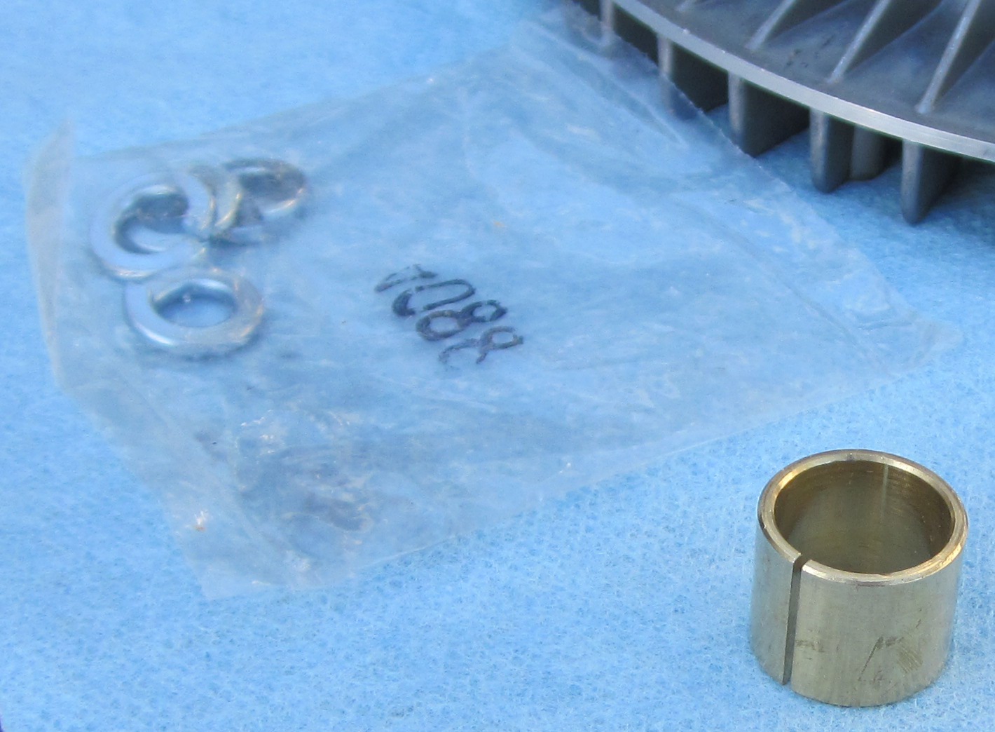

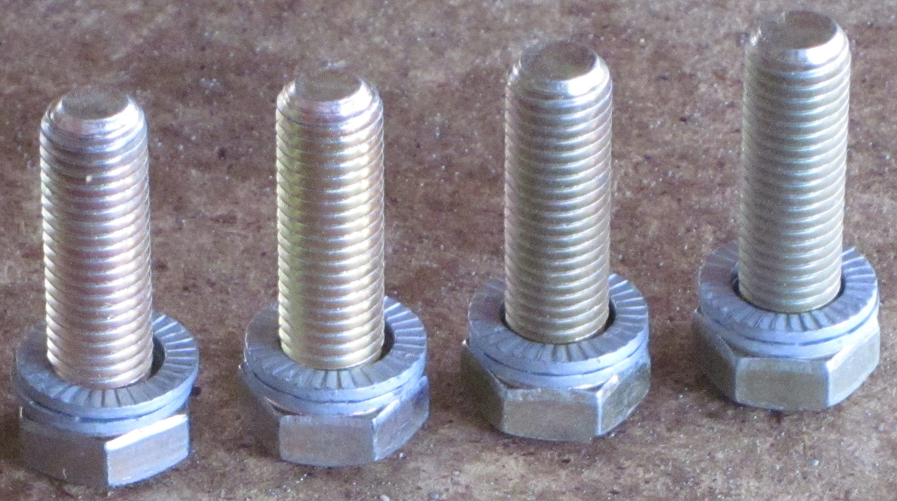

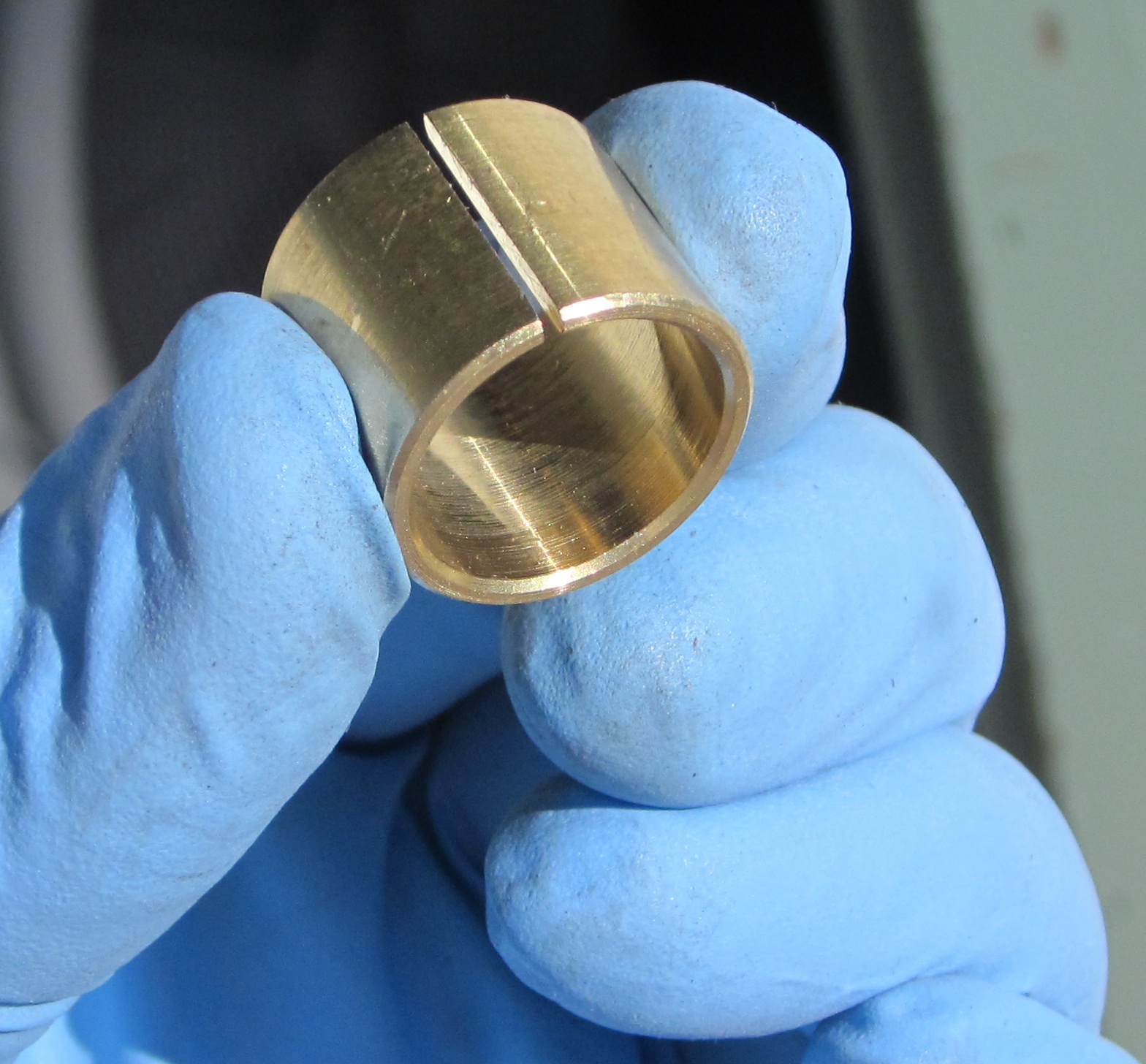

It came with this water pump pilot size adapter, which turned out to be required for the Edelbrock 8805 pump (which must have the same pilot size as the OEM pump). It also came with some lockwashers, but I wound up using medium-strength threadlock instead (more on that in another post later on).

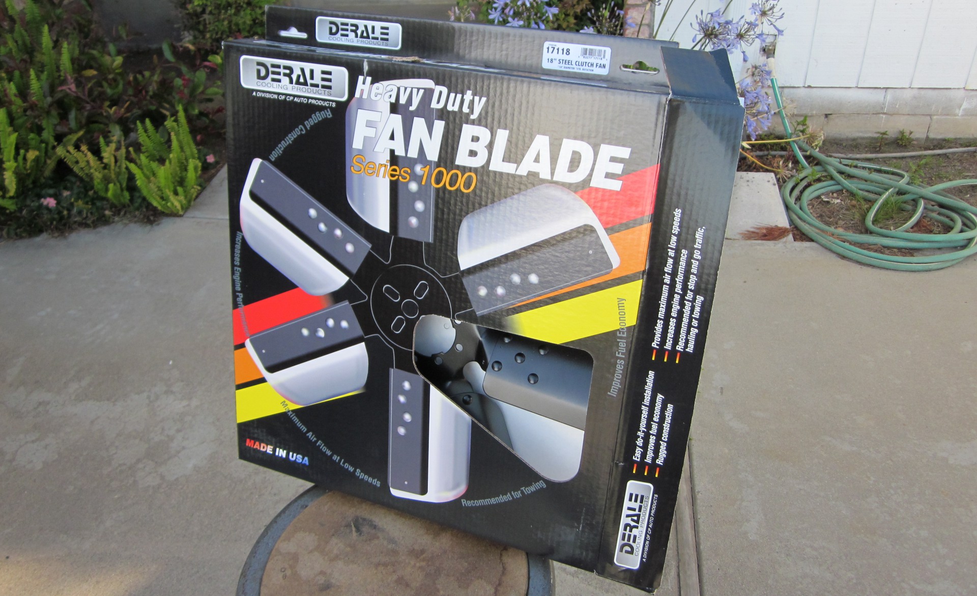

And here's the fan! It looks like a quality unit.
I'll post another update soon as I get these parts installed.

70_F100, Bill, and Hemmi06, thank you again for your generous help!!!
Robroy

Here I'm fastening the fan to the clutch using 5/16-18x1/2, grade eight bolts. The instructions that came with the clutch called for 5/8" long bolts, but I didn't have those, so I used these 1/2" long bolts instead. To make up for that, I skipped the lockwashers and used medium-strength thread-lock. Since the lockwashers were about 1/16" thick, I think it will be OK. I torqued the bolts to around 18 ft/lbs.
The fan+clutch flipped over:
Here's another look at the adapter that slid over the water pump shaft. This adapter interfered with the front face of the March water pump pulley, so it wasn't able to slide on all the way. It got far enough on there that I think it'll be OK though.
After another trip to the hardware store, I had these 5/16-24, 1" long grade eight bolts. I measured the depths of all the parts they'd need to pass through and came up with about 7/8", and the Nord-Locks are about 1/8" high, so these seemed like they'd be a good fit.
Here's the fan+clutch attached to the water pump, with the shroud ajar.
With the shroud installed, you can see the placement of the fan relative to the shroud opening. If the fan's ideally 50% inside, and 50% outside of the shroud opening, then this setup might benefit from being extended 1/4" or 1/2". I'll drive it as-is though for a while since it will probably be just fine, and finding such a short extension might be an adventure of its own.
I fired it up, and noticed immediately how quiet it was! This is an enormous improvement over the giant 19" fan I'd previously installed. I drove the truck a few miles and couldn't hear the fan at all! I suppose I'll only know how well this solution will work out by driving the truck under a bunch of different conditions, but I'm pleased so far!!!

Indeed, it seems that way, although the fan looks like it could stand to be 1/4" or 1/2" closer to the radiator (more on that below).390Nut wrote:You wont be needing the fan spacer on the water pump anymore, in case it wasn't mentioned above (sort of skimmed through the thread).

One very good option for extending the fan towards the radiator, is to take a stock fan spacer and cross cut it as thick as you need it. It is solid with the holes already where you need them. A little deburr here and there, maybe polish it up to match those pulleys, and you're in business.
