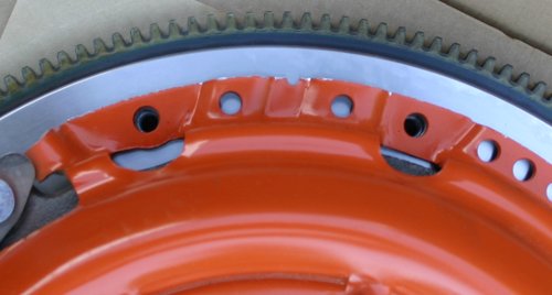

Today I tried to bolt the pressure plate up to my flywheel, but the pressure plate is too large; the threaded holes in the flywheel are about 1/4" or 1/2" closer to the crankshaft than they should be.
This is the factory flywheel, which I've since had resurfaced, balanced, and had a new ring gear installed.
My truck came from the factory with a 360 engine, and the factory clutch is 11" wide. I just measured the DF200015 clutch and it's just about 12" wide (a little less, but basically 12").

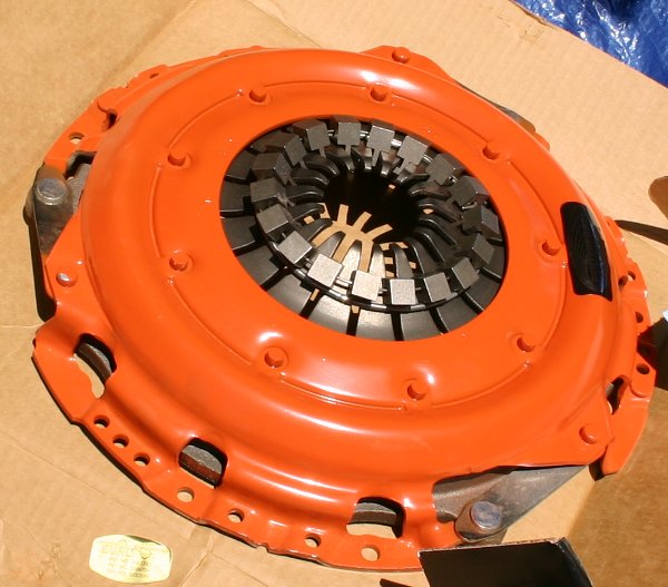

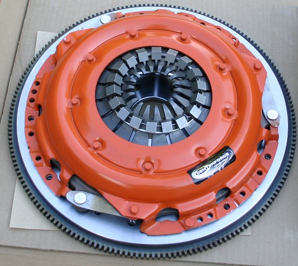

I took some photos last weekend of these parts; here they are:
The factory flywheel (that won't work):

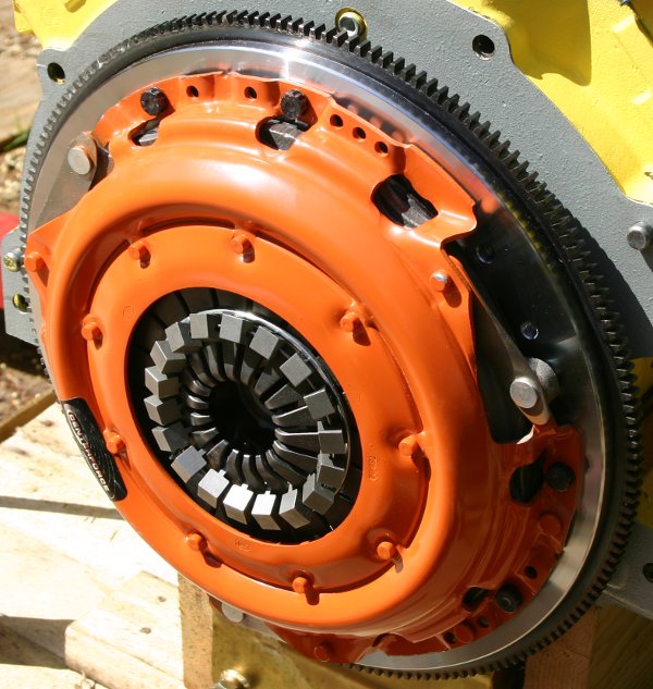

The pressure plate:

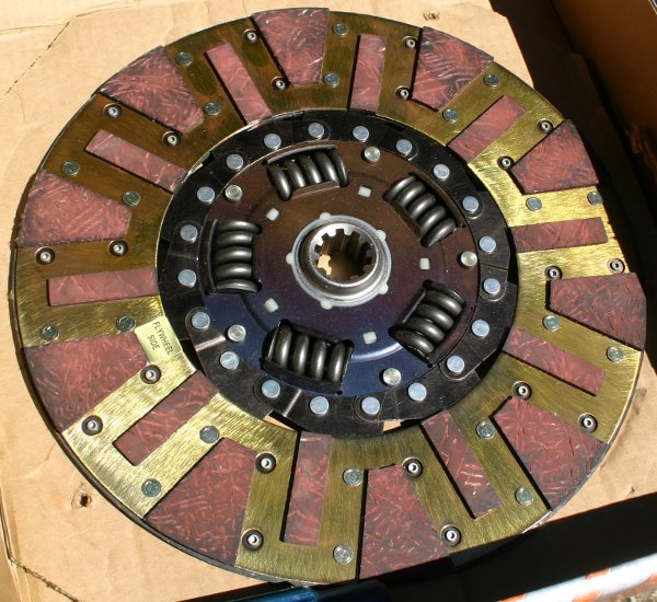

The flywheel side of the clutch disk. This clutch disk measures a little under 12", but definitely larger than 11.5".

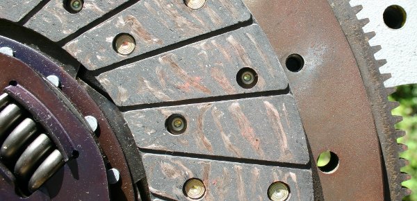

The clutch disk on the old flywheel (the flywheel that won't work):
In this photo you can see how the mounting hole for the pressure plate is pretty close to the clutch disk. In order to work with my pressure plate, the holes will need to be about 1/2" closer to the ring gear.

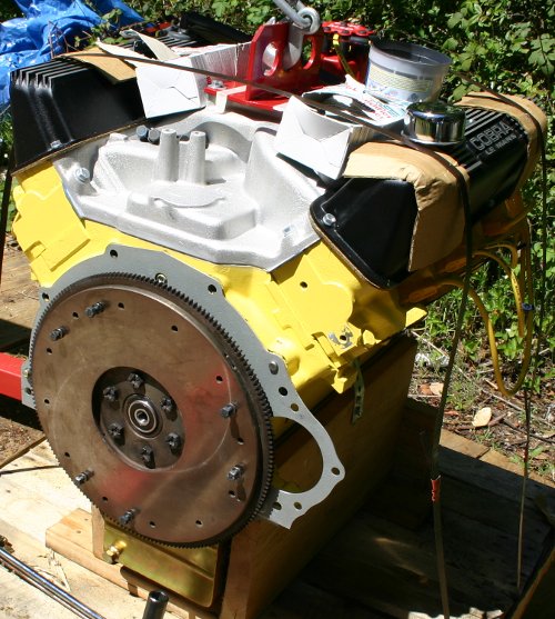

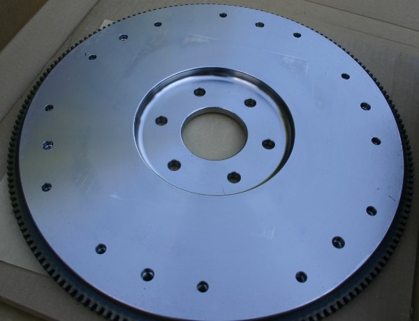

I ordered some new bolts since I thought they could be an improvement over the high mileage bolts from my old engine. The old bolts had somewhat worn threads.
Those bolts are 12-point. I'm not sure what the benefit is to that--does anybody know?

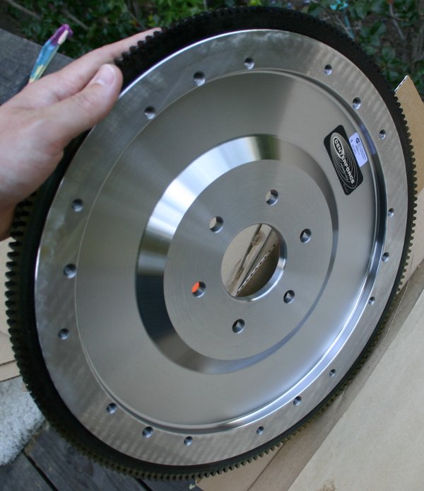

The new flywheel in its box. It's crazy how quickly this thing arrived. I ordered it on Monday morning and it was here on Tuesday.
It's a good looking item.

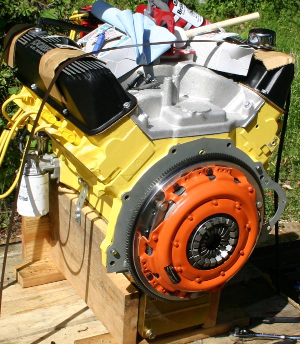

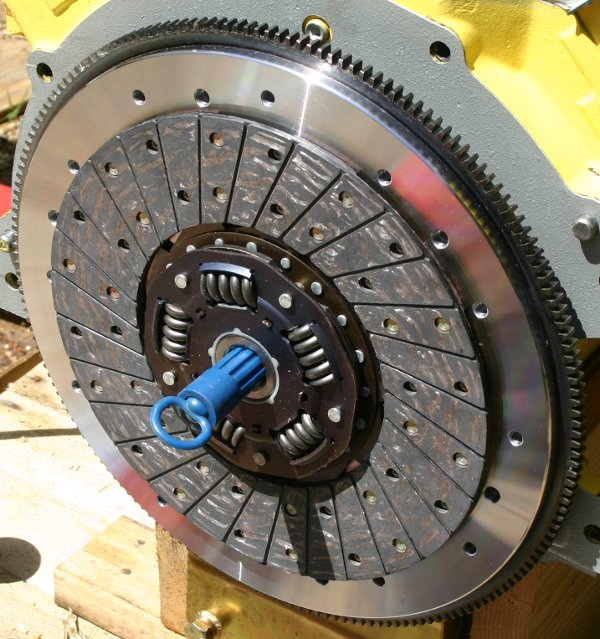

And the pressure plate lines up perfectly with its holes, thank goodness.
The clutch in place.
Now I have an exceptionally nice flywheel for an 11" clutch on my hands. It was just resurfaced, balanced, and has a brand new ring gear installed. Zero miles. Maybe I'll sell it to somebody looking for one of these.

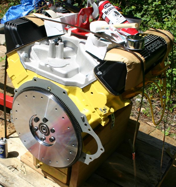

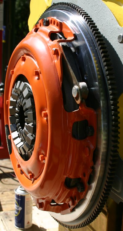

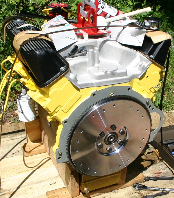

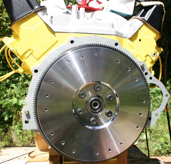

Here are some photos of the installed flywheel and pressure plate!
The sun was glaring off of that mirror like finish and blinding me!
And the pressure plate--the bolts lined up perfectly with this flywheel.
This particular problem is now solved! Thanks for the great advice.
