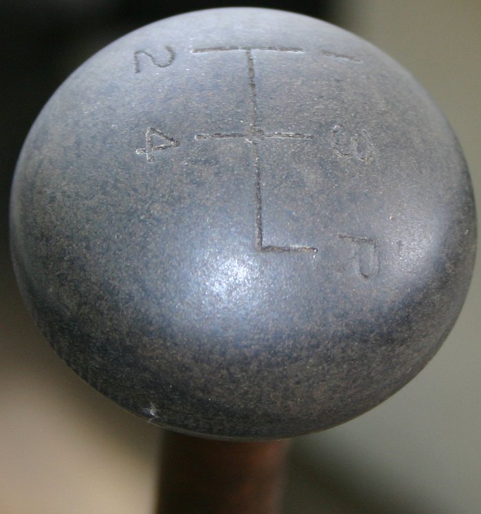

I finally found the photo I took of my shift knob; I want this puppy to look like new.
-Robroy

Hey Steve I'd actually be quite interested in that, if it's not too much trouble!
That shift knob must have low miles on it for paint to have clung there all these years. Any idea how many miles are on that vehicle?
Thanks!
-Robroy
Thanks!
-Robroy

Hey Steve! Yes thanks very much for taking the time to post such great photos of the shift knob!
They did help me out; I'm sure the appearance of your shifter is the same as the T18 appeared when it was new, even though it's an older transmission.
I'll have to tackle mine and try to get it to look nice like that!
Thanks again Steve!
-Robroy
