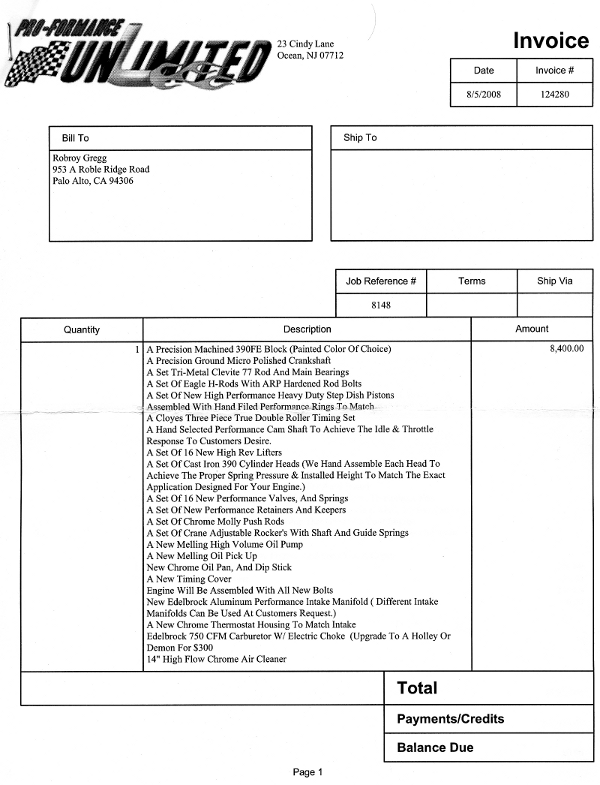

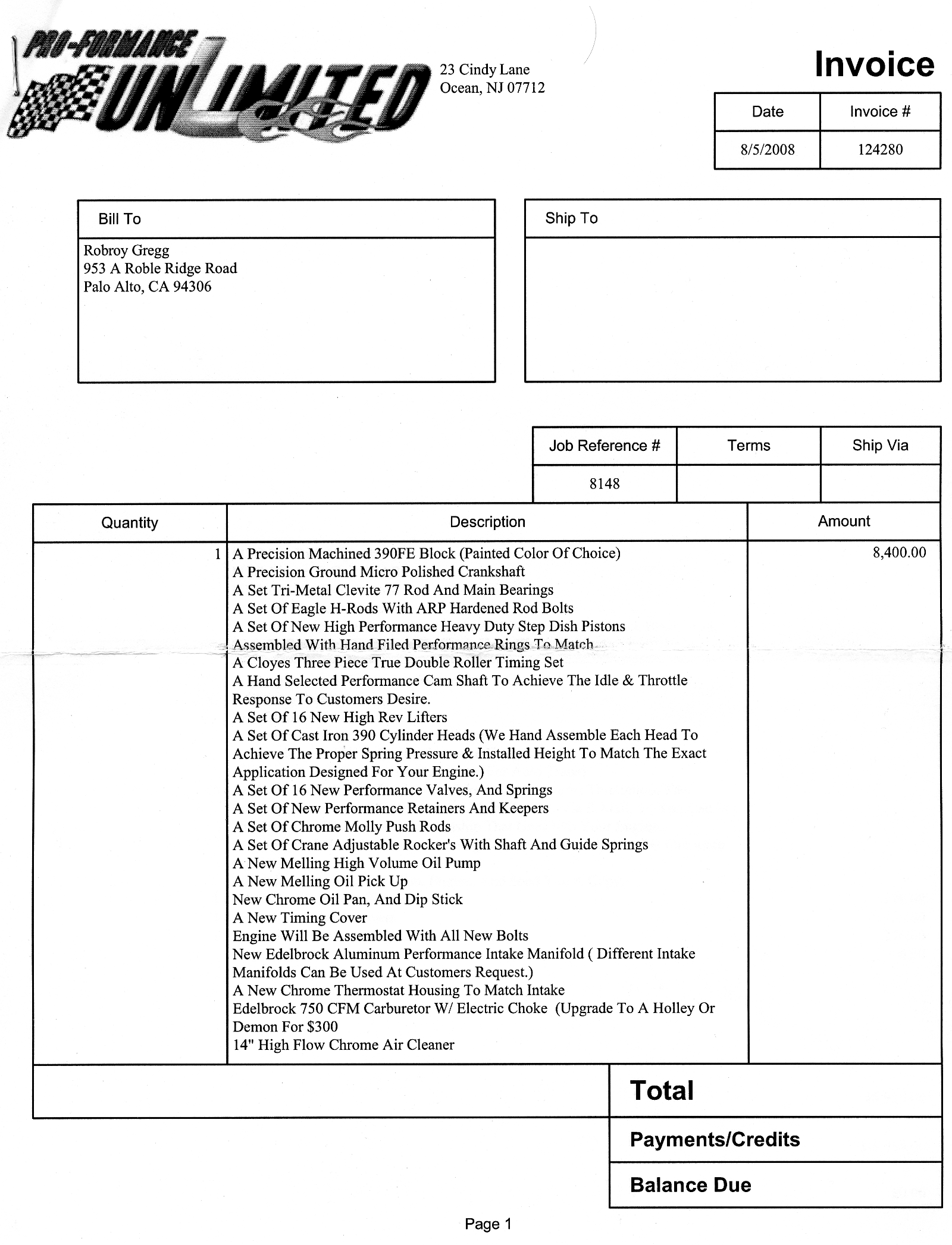

70_F100 wrote:What about the following quote:
"Block Painted With 3 Coats Of High Temp Ceramic Engine Paint Customers Choice Of Color"
There is no way that paint was high-temp OR ceramic.
I've been doing a little research on this point. According to Archive.org's "Wayback Machine," which supplies historical, recorded copies of web sites, the Proformance Unlimited advertisement for my engine did not mention using this "High Temp Ceramic Engine Paint" in April of 2008. I ordered my engine just a few months later, so it's entirely possible that when I ordered the engine, the web advertisement did not make this claim!
Furthermore, the invoice I received from them doesn't mention this. All it says is "Painted Color of Choice."
So it seems that there's no fair basis for me to raise this issue with them. This said, it obviously would have been nice to have had a higher quality paint job on the engine. But I'm not aware of any specific claims that they failed to live up to.

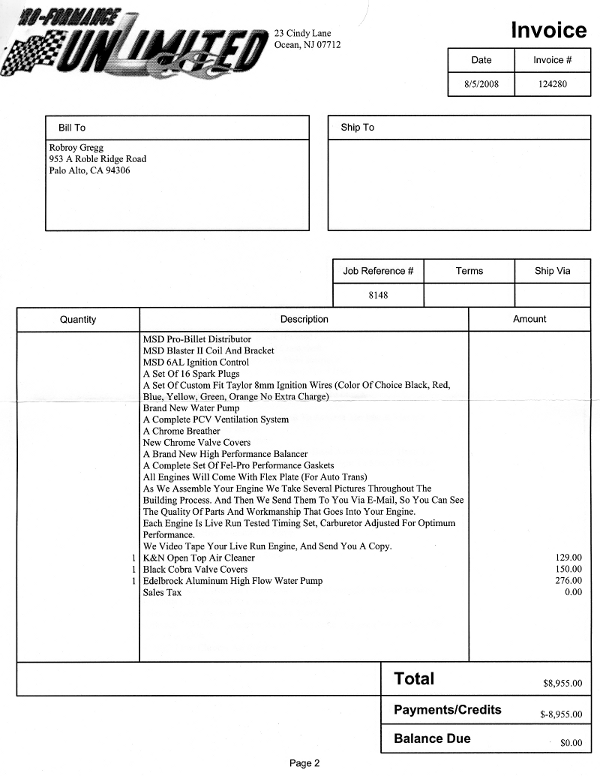

For your analysis and amusement, here's the invoice I received from them--note that it shows my old Palo Alto address (before I moved to Salinas):
ToughOldFord, Robert, SideOilerFE, 70ShortWide, and 70_F100, thanks very much for your excellent advice!!!
Robroy

looks like you were shorted a set of H-beam rods too
edit: its weird that they didnt break down how your money was spent. they just charged you 8400 for a block... most shops would have an itemized list with individual prices.

70shortwide wrote:looks like you were shorted a set of H-beam rods too
Oh is this so? I'm not familiar with the difference between H-beam and I-beam rods, so I didn't pick up on this difference. Are these H-beam rods more desirable than the rods I wound up with? EDIT: I just did a Google Images search for both types and see what you mean! The H-beam type rods look stronger.
Thanks again Jeff!

I may be mistaken. ( I didnt search very hard for the post where you mentioned it) but I believe you mentioned that the stock rods were reconditioned and used in your motor? I would prefer the eagle H beams, they are an aftermarket stronger rod. not that they wouldnt have held up in this combo, but it looks like its another part that you paid for and didnt receive?
I havent ever built an fe, but eagle is a well known brand and provides a good product. where the stock rods are likely strong "enough" I believe eagles would be stronger. someone chime in here and say whether they would be beneficial with this build...

70shortwide wrote:edit: its weird that they didnt break down how your money was spent. they just charged you 8400 for a block... most shops would have an itemized list with individual prices.
My thoughts exactly! When I first began dealing with Proformance Unlimited, this is one of the first things I noticed. I asked Steve if he could provide me an itemized list that showed how much each part cost, but he wasn't interested in doing this.
At the time, I naively thought that engine builders just operated that way, and that I was asking for something rather out of the ordinary!
Then I saw Tom Lucas's draft invoice. Although he doesn't necessarily spell out every single nut and bolt, it does have all the major components itemized on there, with prices. I didn't know what I was missing before now!
70shortwide wrote:I may be mistaken. ( I didnt search very hard for the post where you mentioned it) but I believe you mentioned that the stock rods were reconditioned and used in your motor?
You know, I may have mentioned this, but I don't remember it now. I'll ask Tom exactly what connecting rods he found in there, just to be sure.
70shortwide wrote:I would prefer the eagle H beams, they are an aftermarket stronger rod.
Good to know!
70shortwide wrote:not that they wouldnt have held up in this combo, but it looks like its another part that you paid for and didnt receive?
This could be! And since this is a potentially factual discrepancy between what I was promised and what I received, I can add it to my list (after I confirm it with Tom).
70shortwide wrote:I havent ever built an fe, but eagle is a well known brand and provides a good product. where the stock rods are likely strong "enough" I believe eagles would be stronger. someone chime in here and say whether they would be beneficial with this build...
Interesting! Yeah I'll be curious to here what folks say.
Thanks very much for noticing that detail on the invoice Jeff!

I dont think i saw mentioned new cam bearings in the Por-Formance Limited invoice. Or did I miss that.

Post by DuckRyder »
390 FE rods are quite strong, I don't really see "H" beam rods as necessary.
One thing that has been bothering me for a while about PU, and that invoice is even worse than the website, is that in my opinion the information is crafted to make the reader think that that they are getting something they are not (or at least more than what they get).
Most shops would at the minimum itemize the parts individually (with exception of small stuff which would be "shop supplies").

DuckRyder wrote:390 FE rods are quite strong, I don't really see "H" beam rods as necessary.
thats kinda what I was thinking. sounded as if tom was planning to reuse the stock rods as well. I think we agree that they should be tough enough for the job with him backing them.
the way I see it, If he paid for them, he should have them. poorformance unlimited is starting to look more and more crooked imho

Good afternoon Tim, Robert, and Jeff, thanks very much for your excellent replies!
OldRedFord wrote:I dont think i saw mentioned new cam bearings in the Por-Formance Limited invoice. Or did I miss that.
I think you're right! Yet based on the nature of the invoice, it doesn't surprise me that there would be omissions. It appears to be more of a stream-of-conscious invoice than an actual, logical itemization. It looks like a rough draft of some kind doesn't it?
Ah-ha, thanks for letting me know!
DuckRyder wrote:One thing that has been bothering me for a while about PU, and that invoice is even worse than the website, is that in my opinion the information is crafted to make the reader think that that they are getting something they are not (or at least more than what they get).
I know exactly what you mean. A list that's incomplete, somewhat inaccurate, and lacks itemized prices is dubious at best. It leaves me thinking, "What exactly am I paying for here?" In retrospect, I should have paid more attention to my intuition up front, which was saying much the same thing. I kept thinking, "Am I expecting too much to want to know about every single detail here?"
DuckRyder wrote:Most shops would at the minimum itemize the parts individually (with exception of small stuff which would be "shop supplies").
Good to know!
DuckRyder wrote:Edit: Oh on the tire, if you can just give the size ( like 235/75/16) we can figure the nominal height and or revolutions per mile. ( looks like standard was 800x16.5)
Oh! That makes complete sense. I read this on the side of a tire, "9.50R16.5 LT 116/1120 M+S LOAD RANGE D." I'm quite ignorant on the subject of tires; does this string contain the size information?
Excellent! Good to know that they'll work, at any rate.
70shortwide wrote:the way I see it, If he paid for them, he should have them. poorformance unlimited is starting to look more and more crooked imho
I completely agree that I should have received what I paid for! About being crooked, my inclination is to attribute something like this to a mistake rather than meditated deception. Yet either way, they ought to be liable to provide the parts I paid for. I'll have to confirm the exact make and part number of the connecting rods with Tom!
Oh, I agree as well, I didn't mean to imply otherwise...
Most seem to agree that stock 390FE rods with ARP bolts properly installed and torques are as good (or better) than the old "LeMans" rod.
I was cruising the FE Forum earlier and it seems Eagle might not be the way to go at least for an FE.
