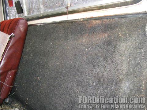

There was a guy listing a '71 Camper Special on E-bay a while back. The original buckets had been replaced with some from another vehicle, but the rest was still intact. I had to contact him and act like I was interested in the truck just so I could get him to send me the following shot of the factory tank cover:
There was a special 2-piece chrome strip that ran along the top of the cover. I've seen one set listed on E-bay in the last 3-4 years. I bid on it but got outbid by a large margin.

Hey,thanks for that pic,Keith...I thought there might be some hardware or something back there...One option I have with my truck is the p. o. had one of those camper crawl-through window boots around the back window that was held on with those snaps....The snaps are still there,and I suppose I could use the lower ones to hold the carpeting---Not factory,but who's to know?

Here is a couple of pics.

Hey,Big D,thanks for posting those....That interior flows real nicely,and looks very comfy...Gives me some good ideas on what to do with mine---among other things,vacuum the carpet before I take pics of it

I believe that the headliner and door panels are just flat board made off the originals covered with the material and padding. I'm trying with the camera. I didn't think they loaded I got all pissed off night before last cause I thought they didn't load. Yeah it is not my truck so the vacuuming is on them.Joe Kriston wrote:Hey,Big D,thanks for posting those....That interior flows real nicely,and looks very comfy...Gives me some good ideas on what to do with mine---among other things,vacuum the carpet before I take pics of it![]()
