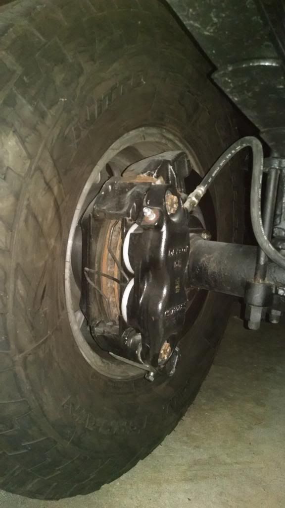

My 72 F250 4WD had factory power brakes, when I switched my rear dana 60 to disc brakes I also switched my front to A 76 dana 44 that had disc brakes. My logic was I had 4 wheel drum brakes before, I now have 4 wheel disc brakes, what is the difference in the master cylinder and the proportion valve, my answer was there is no difference. I have been driving it for over a year and not one problem. You can lock it down and of course it will slide all four wheels, but you can press the pedal to the point just before lockup and you better hang on because it will flat stop you in a hurry. I have had several of these old trucks but never had one that stops like this one.
Here is the disc conversion info I used
http://www.ncspecialties.com/autobody/r ... /index.htm
Rear dana 60 with disc brakes
