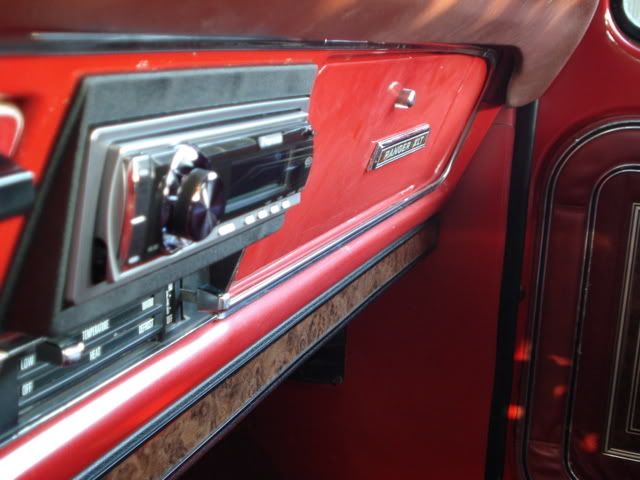

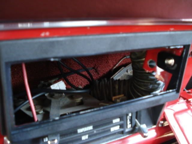

No modification to the plastic kit if i remember correctly (i did the install also) You just have to bend the metal ears back that hold the factory radio in and drill two holes!

thats awesome! i was afraid to put in a radio in my 69 because i didnt want to butcher up a perfectly good dash, i was gonna do the glove box delete stated in this forum but now ill have to consider this, how much does the volvo kit run?

i think it was $20 at best buy!!!

that is a steal for something so cool, hmm that would look awesome with the white guages and blue leds.

The only difference between the Volvo and the Bumpside installation is it gets installed upside down in a bumpside. :thup:
