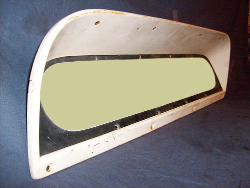

I was thinking about if I could use this bezel from a 1967.

Sure. Just cut the front gauge portion of the face off, leaving yourself about 1/2" or so around the perimeter to attach your gauge panel to. Just cut out the shaded portion of your panel in this pic:dolinick wrote:I was thinking about if I could use this bezel from a 1967.
http://farm2.static.flickr.com/1251/116 ... 179f30.jpg
I guess a digital display is still out of the question.
Dan
[img]http://www.fordification.com/board/intr ... cut[2].jpg[/img]
The black part of the face that remains is flat. You can cut your new instrument panel face to cover the black section and then add the gauges of your choice.
