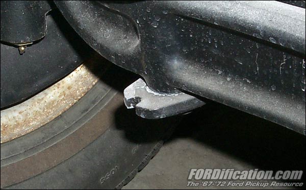

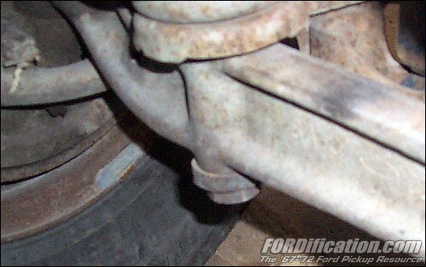

You mentioned that you got your swaybars from a junkyard truck, and that you got the I-beams. The factory front swaybar will work with your existing I-beams, so those aren't needed. However, the swaybar installation does require special radius arms...did you save those too? They'll be slightly extended forward and are notched to properly locate the swaybar mounts. The alignment pin is built into the swaybar mounts. Here's a couple comparison shots. The first picture is of a standard bumpside-era radius arm. Notice how they're flush with the front of the I-beam:
...and here's a shot of a dentside-era radius arm set up for a swaybar (not all were). You'll see how it's extended with a notch for the swaybar mounting bracket:
